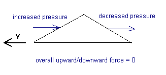

Please click here first for some illustrations (otherwise it might be difficult to get my point across).
The aerodynamic lift on the wing of an airplane (airfoil) is generally explained by the argument that the faster speed of the air along the top of the wing leads to reduced air pressure there and hence produces a lift (Bernoulli's Law).
Using this argument, one should also expect a lift for a symmetric wing profile as shown in Fig.1.
However, if one considers the problem from a microscopic point of view, one comes to a different conclusion: upward and downward forces should exactly cancel for a symmetric wing profile.
This is easy to see if one simplifies the situation and replaces the curved wing surface by two plane sections (Fig.2):
If the wing is stationary, the pressure on all parts of the wing is identical, i.e. there is no lift. If the wing is moving in the indicated direction, the front half of the upper wing surface experiences an increased pressure because of the increased speed and number of air molecules hitting it (due to the orientation of the surface, this creates a downward force). On the other hand, the rear half experiences a reduced pressure because the of the reduced speed and number of air molecules hitting it (creating a lift). Overall, there is consequently no lift, but only an anti-clockwise torque.
It is obvious that an overall lift is only achieved if the rear section of the wing has a larger area than the front section, i.e. one would get the maximum lift for the profile in Fig.3 (and this is (schematically) actually how airplane wings seem to be designed (see for instance http://www.zenithair.com/kit-data/ht-87-6.html).
On the other hand, the reverse situation (Fig.4) should lead to a downward force, although Bernoulli's Law would again predict a lift.
Note: the above arguments assume that the lower surface of the wing is always parallel to the velocity vector, i.e. the pressure acting on it is unchanged; by varying the 'attack angle' of the wing the amount of lift can of course be arbitrarily be changed and one could even generate a lift for the bottom image.

Ah, but you are ignoring the reason why Bernoulli's equation works: an assumption of incompressible flow. This assumption is valid up to ~Mach 0.3.
If the flow is incompressible, then when the streamlines reach a disturbance (i.e. the airfoil), the streamlines must become smaller. In other words, since you can't shove more mass into a smaller space, the flow must speed up to get out of the way.
In your first image (symmetric about the c/2 point), the flow will slow down again once you pass the c/2 point, increasing the pressure and obtaining zero lift.

This is not a simplification by any means. A triangle in a flow is not an accurate simplification unless you are going at supersonic speeds. Nature abhors discontinuities. The sudden change in angle on the top of the wing will cause flow separation and turbulence, resulting in a huge drag (and because of the geometry, a downward force).

Using that airfoil is anything but obvious. Trying to model a 'wing' with a flat front plate cannot be done easily. The air will come practically to a full stop and then get pushed about to either side, again causing major turbulence.
On the other hand, the reverse situation should lead to a downward force, although Bernoulli's Law would again predict a lift.

The object in Fig.1 will indeed generate lift. Anyone who's thrown a Frisbe can tell you that.
Fig.2 will also generate lift, but the virtex formed at the downwind side of the peek will decrease the efficiency of the lift. BTW; These vortices can be used to create usefull lift also, that's how the F-117 "Stealth Fighter" flies.
The object in Fig.3 doesn't create lift because the airflow is hopelessly disrupted, (NOT because of a failing of Bernoulli's law).
Fig.4 shows an object that will, beleve it or not, create lift. It would also create horrendous amounts of drag, and the lift-to-drag ratio would make it a terribly inefficient wing. But try it, it will lift (some).
I am not exactly familiar with frisbees, but I doubt that you could create a lift with a zero angle of attack. A lift only developes if the airstream can support the underside of the frisbee, i.e. you have to tilt it somewhat when you throw it (I found a http://www.mansfieldct.org/schools/mms/staff/hand/flightfrisbee.htm)
I cannot see how the profile of Fig.4 could generate any lift. The additional momentum created by the airstream would, apart from the drag, have a vertical component that points down but not up. Racing cars use similar aerodynamic profiles in order to have better contact with the ground, not in order to take off.
Which brings me back to a rather significant point; now that you have your proposed designs, and have formed hypotheses predicting their behavior, you should go to experimentation. If you cut the shapes out of styrofoam, or make them out of peper or something, you can turn a fan on them and see which ones get pushed strait back, and which ones get lifted up. Might be fun. (Have you ever done the experiment with the spool of thread and the sheet of paper? That one is just cool!)
The problem with your proposed experiments is that if you are using materials so light that they easily lift, they are also easily blown away. One would need to fix the object to a sensitive scale and in this way verify the lift force.
Anyway, observing a lift in a given case does not help to understand it, in particular as there may be complicating factors like turbulence etc.
