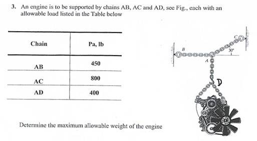

Please help me figure out how to solve the attached problem.
I understand the equilibrium equations for 2 chains (http://www.glenbrook.k12.il.us/gbssci/phys/class/vectors/u3l3c.html ) but not for the third chain attached to the load.
Thanks-
Lith

Draw a free body diagram and you will see how the 3rd chain comes in. Point A is a good place to isolate for a FBD.
