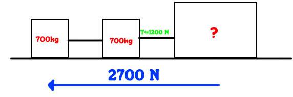

A transport plane takes off from a level landing field with two gliders in tow, one behind the other. The mass of each glider is 700kg, and the total resistance (air drag plus friction with the runway) on each may be assumed constant and equal to 2700 N . The tension in the towrope between the transport plane and the first glider is not to exceed 12000N.
If a speed of 40m/s is required for takeoff, what minimum length of runway is needed?
What is the tension in the towrope between the two gliders while they are accelerating for the takeoff?
F=ma
First I drew the problem out. On how I see it.
Now I will draw the forces on each object separately.

Now assume the rope in the middle has the maximum tension allowed. Now figure out the acceleration. Hint: Consider the two gliders as a single system. What's the net force on those gliders? The total mass?
Total Mass would be 1400kg.
Net force would be 2(tension pulling from Transport Plane).
If this is correct, I will go on to the next step.
The basics I just learned from you. :)
The part I don't understand is now that I have an "single" object of 1400kg, the weight and normal force cancel out and the only horizontal force left is unknown. :O
The transport plane has also a weight and normal force that cancel out, the boost it's getting is larger than the tension from the left. But for this one I don't got values. :(
I went a little ahead and know that once I have the acceleration, I will be able to plug it into this equation. v^2 = vi^2 + 2a(x-xi)
The net force on the gliders is that single tension from the rope attached to the Transport Plane. And that tension is given! (The rope between the gliders pulls in both directions, so its tension cancels out when looking at the system of both gliders together.) (Edit: Oops--my bad! We forgot the resistance acting on each glider, which is also given.)

Right approach, but we need the correct net force on the gliders. In my last post, I forgot about the resistive force that acts on the gliders, which is also given. :redface:
In light of that, what's the real net force on the gliders? (Also: The towrope tension is 12,000 N not 1200 N.)
The resistive force is 2700. (This is where it confuses me, does this include the transport plane, or just the gliders.)
12000-2700 = 9300
9300 = 1400a
a= 6.64 m/s^2

Reread the problem statement:
Heat said:
The mass of each glider is 700kg, and the total resistance (air drag plus friction with the runway) on each may be assumed constant and equal to 2700 N.
got it so the friction should be 2700. friction should double.
12000-2(2700) = 6600
6600 = 1400a
a = 4.71
Looks good.

First off, the net force is the sum of all forces acting on the glider. There are two: The tension (T) to the right, and the resistive force (which is given) to the left. Add them and set that sum equal to ma.

Yes, the net force is the difference (or sum): +T - F(resistive) = T - 2700. Set that equal to ma.

Where does the 14700 come from? Do over!
T - 2700 = 700(4.71)
T = 2700 + 3297
T = 5997
I just understand that it was +T and -F. This should be right now. If it is, I would like to thank you Doc Al.
Looks good to me. (But don't forget units when submitting your answer.) Why don't you mark this one as "solved"?
