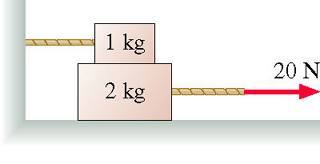

The 1.0 kg block in the figure (attached) is tied to the wall with a rope. It sits on top of the 2.0 kg block. The lower block is pulled to the right with a tension force of 20 N. The coefficient of kinetic friction at both the lower and upper surfaces of the 2.0 kg block is mu_k = 0.500.
What is the tension in the rope holding the 1.0 kg block to the wall?
What is the acceleration of the 2.0 kg block?
F_a on b = -F_b on a
a_ax = - a_bx
I started by drawing force diagrams for both boxes and then calculating the net force in the x-direction for each box.
For box 1:
Fnet x = -T_1 - (mu_k)(n) = -1T_1 - (0.5)(9.8)(1) = -1T_1 - 4.9
For box 2:
Fnet x = T_2 - 2(mu_k)(n) = 20 - (2)(0.5)(20.6) = -0.6
At this point, I've tried to find the acceleration by setting the Fnet = ma, but get the wrong answer for the acceleration and solving for T_1. Anyone know where I may be making the mistake?

The first equation's true but the second is not: the top box doesn't accelerate.
For box 1:
(1) Careful with signs: What direction does the friction act?
(2) What does the net force equal?
For box 2:
Recompute the friction forces. Realize that there are two friction forces acting on box 2, but they are not the same; write each one separately.

Thanks! I rewrote the Fnet as you suggested:
Box 1: Fnetx = (mu_k)(n) - T1 = 4.9 - T1
Box 2: Fnetx = T2 - (mu_k)(9.8)(1) - (mu_k)(9.8)(2) = 5.3
I set Box 1 Fnet = 0 and was able to solve for the first part of the problem.
For the second part of the problem (finding the acceleration of box 2), I tried to use:
Fnet = (m)(a) = 5.3 = (2)(a)
which gave me 2.65 m/s for acceleration, which was incorrect.
I'm assuming I have to use the Fnet for box 2 because it does have a net force, unlike box 1. Did I calculate Fnetx for box 2 incorrectly?
That second friction force is incorrect. Hint: What's the total force that box 2 exerts on the floor?

Thanks so much! I had just realized that I had to change the mass somewhere when you replied. Thanks again for pointing me in the right direction!
