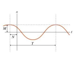

The graph shows the position x of an oscillating object as a function of time t. The equation of the graph is x(t)=Acos(wt + [tex]\phi[/tex])
where A is the amplitude, w is the angular frequency, and [tex]\phi[/tex] is a phase constant. The quantities M,N, and T are measurements to be used in your answers.
See attached image.
What is [tex]\phi[/tex] in the equation?

The attachment has to be approved, but the phase angle (constant) is found for example when t = 0, and knowing x(t=0) = A cos [itex]\phi[/itex], or
[itex]\phi[/itex] = cos-1 (x(0)/A), or
if x(t) is known at t, then
[itex]\phi[/itex] = cos-1 (x(t)/A) - wt
the answer leads to 0.5pi.
