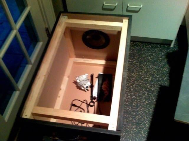

Some background information:
I am trying to cancel audio signal/noise in an enclosure I have constructed.
I have two identical woofers positioned opposite each other in the enclosure.
I have a very accurate sound level measurement microphone positioned between the two drivers.
I am using sound measurement software to initiate a sweep of the frequency response range of the woofers.
After several trials, the graphs of the speakers (unadjusted) proved to be almost perfectly the same, which leads me to believe that me hardware is not lacking in quality.
I then proceeded to switch the banana clip inputs from one of the speakers on the receiver/amp from red>red and black>black to red>black and black>red. I left the other speaker alone, and its inputs maintained their designed locations.
Next, I ran the same audio sweep tests and compared the graphs of the one speaker reversed tests to those of the "control" all speakers normal tests.
Oddly, the graphs of the speaker reversed test were rarely of less amplitude then the normal tests. Only in some places on the graph, was the reversed speaker test lower than the normal test, as I thought it should be.
In most cases on the graph, the amplitudes of the normal test were less then the reversed test
Correct me if I am wrong, but I thought that if I reversed the terminals on one speaker, and therefore changing the phase 180 degrees, it would yield considerably less noise in comparison with both speakers operating in phase.
My main goal here, is to cancel noise.
Can someone correct my theory and point me in the right direction?

Unfortunately, simply placing speakers out of phase will induce destructive and constructive interference at various places, and thus simply cancel or boost both noise and signal equally at those places and each frequency.
The only way to remove noise from the original signal is by creating a circuit or mechanical device that can somehow recognize the difference between signal and noise and cancel it--for example with out-of-band noise (like hiss going in to a woofer) you might simply use a frequency domain filter. In-band noise (in the original signal) cancellation requires a circuit or device intelligent enough to somehow recognize the difference between signal and noise, if possible. For example, if the "noise" were really simply distortion, then a special circuit or device can be designed to undistort the signal as long as the original distortion doesn't cause information to be lost. But by "noise" I'm assuming you mean unwanted in-band energy in the signal which is uncorrelated with the signal (distortion is correlated with the signal, so its easier to recognize and thus remove).
There are two reasons you might see frequency response change when you swap the phase to one speaker:
1. If you run your response test while driving both speakers with similar (stereo) or identical (mono, or one stereo channel) signals, then note that the phase you choose for the speakers will also alter the impedance of each speaker, and at different frequencies (the cone moves less or more, depending on the wave from the other speaker--that translates to a change in how much power the speaker converts to sound). So you'll see a different response depending on the phase you choose. Also note that a circuit designed to flatten the response of a speaker in an enclosure will be different depending on the phase of the speakers (assuming at least some correlation between the signals applied to each speaker).
2. Speakers are non-linear. If the signal you used to measure response was not symmetrical, then the distortion from that non-linearity could affect the response. The non-linearity becomes more noticeable with the power. Try your test with very low power (and don't drive the other speaker at the same time) and I believe you'll see negligible correlation between the phase you choose and the response for a given single speaker.

That would make sense for in a room, but as I have stated, we are working with a small enclosure, and only one listening point.
To clarify, I have watered down our actual experiment and procedure a fair amount, I am just trying to figure out a way to get this active noise cancellation system working.
This is just a proof of concept device. Pictures of the enclosure are attached.

I think the "noise" he's talking abotu is the sound from the speakers. That makes it very predictable, as it is being generated for the purpose of the experiment. Ocacoustics, you are thinking that, because both speakers are producing the same sound wave, at the same time, in opposite directions, then there should be a "quite spot" (or at least qiet-er) exactly mid-way between them, right?
But I think the mere fact that soundwaves are bouncing off the walls inside your enclosure, and arriving at the mic out-of-phase from the waves coming directly to the mic, is going to make things impossible for you. The same waves that cancel some incoming soundwaves will end up reinforcing others.
Just out of curiosity, have you tried moving the mic around, and looking for variation in sound levels? Could be some useful data obtained that way; maybe you are getting partial cancellation, but just not in the exact spot you expected it.
Also, thinking about the reflection problem mentioned above, have you tried this without an enclosure?

If you're only interested in cancelling sound in one spot, and only at some specific frequencies, I suggest you do the following:
Drive both speakers with the same signal, but one delayed with respect to the other (digitally, perhaps). As you vary the amount of delay, you will eventually find a point at which the two signals are 180 degrees out of phase at the mic, and cancel.
Note that this will only work, in general, for pure sine wave tones.
