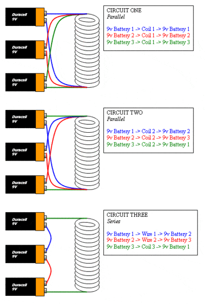

Say I have three different circuits, each with three 9V batteries:
CIRCUIT ONE
Parallel
9v Battery 1 -> Coil 1 -> 9v Battery 1
9v Battery 2 -> Coil 1 -> 9v Battery 2
9v Battery 3 -> Coil 1 -> 9v Battery 3
CIRCUIT TWO
Parallel
9v Battery 1 -> Coil 2 -> 9v Battery 2
9v Battery 2 -> Coil 2 -> 9v Battery 3
9v Battery 3 -> Coil 2 -> 9v Battery 1
CIRCUIT THREE
Series
9v Battery 1 -> Wire 1 -> 9v Battery 2
9v Battery 2 -> Wire 2 -> 9v Battery 3
9v Battery 3 -> Coil 3 -> 9v Battery 1
Am I right in saying that the voltage of the first two circuits is 9V and the voltage of the circuit in series is 27V? Wire 1 and Wire 2 are connections between batteries which are not used to do work. Coils 1 and 2 are used to connect batteries 1, 2, and 3 in parallel. Coil 3 is just like Wires 1 and 2 except it is being used to perform work on a permanent magnet. Which circuit, then, is most suited to utilizing the greatest amount of electricity?
I would say its circuit 2 (though circuit 1 is almost exactly the same). Circuit three wastes the current that travels through Wires 1 and 2 unless these wires are used to do work. Some people say it makes little difference whether you use series or parallel, in that you will get the same energy. But to me, putting the ends of the battery together without doing anything with the current in between is the same as shorting the battery. I would expect the input emf between the batteries to be left unchanged whether they are used to produce work or not. What do you think?

Are the coils in circuits 1 & 2 a single strand of wire with different color leads attached to the coil ends?
Or are the colored strands continuous and lost in the drawing?
Quiz question: What is the advantage of using parallel batteries?
The first two diagrams appear to be equivalent. They each deliver 9V across the load, with three times the current capability of a single battery alone.
The circuit in the third diagram would deliver 27V to the load, but would only be able to deliver the current of one battery by itself.

My guess would be that their internal ESRs drop the overall voltage source ESR by being in parallel, which gets the power supply closer to an ideal battery. Also, you get more power at the same voltage, since each additional battery can source additional current at the voltage.
The first sentence is correct.
The second need some work.
Note: If the colored strands are continuous thru the coil (rather than connected to the ends of the coil) then circuit 2 is equivalent to circuit 3 and not circuit 1.

The current depends only on the resistance of the load and the voltage applied to the load. If you connect multiple batteries in series, neither of those quantities change. All that changes is the total amount of current that can be supplied by the batteries. If one battery is capable of delivering 100 mA, then three batteries wired in parallel can deliver 300 mA. That doesn't mean the load would use all of that capability, though.

I think you may be confused here.
The 150 mah designation is the amount of energy stored in the battery and not the maximum current you can obtain.
In the 9v case your load can draw 150 ma for one hour at which point the battery is dead and you need to get a new one.
Or if you put 6 of the 1.5 v 2500 mah batteries in series (to get 9v) your load could draw 150 ma for 16.6 hours.
Or if you put 3 9v batteries in parallel your load can draw 150 ma for three hours.
The max (short circuit) current a battery can deliver is dependent on its internal resistance and can be very much higher than the mah rating.
