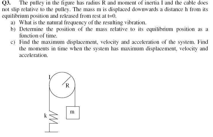

http://img166.imageshack.us/img166/4254/tut5q3ue5.jpg
iv had a go at this and I think I am getting it right but just looking for a bit of clarification since my lecturer isn't giving out answers, helpfull...
ive started off by saying that initially the system is stationary and equilibrium so,
K.X_in = M.G
X_in = (M.G)/K
so MGR - K(X_in+X)R=I(alpha) sub in X_in = (M.G)/K
(MGR) - ((KMGR)/K) - (KXR) = I(alpha) simplify and sub in X=R(theta)
so,
K(R^2)(theta) + I(alpha) = 0
so (omega_N) = R SQRT(K/I)?
any help would be very very helpful!

Your solution is a bit hard to read. Could you possibly type it up in LaTeX? Here is a tutorial for using LaTeX at PF:
https://www.physicsforums.com/showthread.php?t=8997
Also, I don't see where you've used the [itex]h[/itex] anywhere. Are you using a different symbol for that?
Your calculations are correct.
@Tom Mattson for the frequency he does not need to consider [tex]h[/tex]
