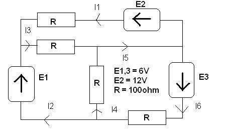

The circuit is attached, i want to know what I4 is ( Answer 15mA ). Been working on this problem for 3h and i always end up when i try to multiply the invert matrix "A" with the matrix "B" then my calculator says "It´s not invertable"..
Kirchoffs Laws
junction equations = 2
loop equations = 4
1: I1+I2-I3=0
2: I1+I6-I5=0
a: R*I3-R*I4=6
b: -R*I1-R*I3=-12
c: R*I4+R*I6=6
d: R*I3+R*I6=12
Matrix A:
6x6
1 1 -1 0 0 0
1 0 0 0 -1 1
0 0 100 -100 0 0
-100 0 -100 0 0 0
0 0 0 -100 0 -100
0 0 100 0 0 100
Matrix B:
6x1
-12
It's easier to do with three loops. This gives 3 eqs in 3 unks.
Call the loop currents A,B,C. Then the loop equations are
12-100A-100(A-B)=0
-6-100(B-C)-100(B-A)=0
-6-100(C-B)-100C=0
