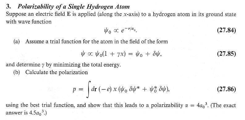

the problem text is attached
I have solved Schrödingen equation, while getting
psi(x)=c1*cos(kx)+c2*sin(kx), where k=sqrt(2Em)/hbar
I cannot understand which boundary conditions I schould use.

Bump; is the approach to use perturbation theory with the Stark effect?
