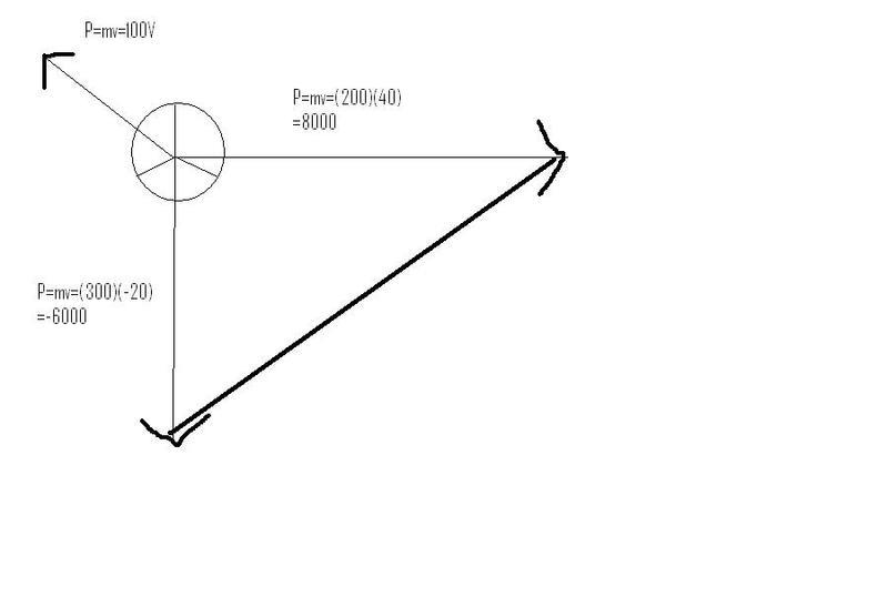

a 600 kg canon, initially at rest, exploded upon firing and broke into three fragments. One fragment of mass of 200 kg traveled east at 40m/s and a second fragment of mass 300 kg traveled due south at 20 m/s. What was the velocity of the third fragment?
sum of P = sum of P'
0= P1 + P2 + P3
I'm not sure whether I'm supposed to use trig or something to find the missing velocity.
Any help would be GREATLY appreciated.

Momentum is a vector quantity, and as such, the sum of the momenta must obey the laws of vector additions. Are you familiar with resultants and vector sums?
This is what I have so far. Am I on the right track?
Will the resultant be the hypotenuse?
http://img408.imageshack.us/my.php?image=physicsay5.jpg
I did Pythragoras to find the missing vector.
(8000)^2 + (6000)^2 = c^2
c=100 m/s
tan[tex]\theta[/tex] = 6000/8000
[tex]\theta[/tex] = 37
I got 100 m/s for my velocity and 37 degrees N of W. Is this right?
c=100 m/s
Yes, that is correct, but your diagram and equation are not consistent with this answer. Looks like you combined a step when solving for 'c' , and the direction of the diagonal is wrong.
