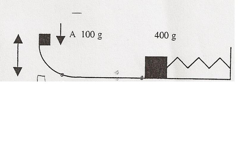

A 100grams block is moving at 2m/s down the curved hill. The block slides along the smooth surface and collides elastically with the 400gram block. The 400gram block is initially at rest and is attached to an ideal spring with spring constant of 500N/m
a)Find the maximum distance the spring compresses
b)Find the maximum height the 100gram block reaches after the collision.
I added a diagram... help me T.T

oh~ height is 3.0m...

SaladSamurai your right... I have to use Work-Energy theorem and Conservation of Energy and the speed is 2m/s at point A and the surface is smooth...

ok … then what is the speed of the 100grams block just before it hits the other block? :smile:
according to my calculation I got 7.925m/s...after this i have no idea...

Now pretend that there's no spring, and work out the speeds of the two blocks immediately after the collision. :smile:
immediately after the collision I got 1.585m/s... is this right?

In collisions, momentum is always conserved.
And you're told that this collision is elastic, and that means that energy is also conserved.
Two equations … two unknowns … physicist's heaven! :smile:
alright for 100gram I got -4.755m/s and for 400gram I got 3.17m/s...it seems wrong..T.T

You now have an initial velocity for the 400gram block.
So … what is the maximum distance the spring compresses? :smile:
I got 0.08966m...
Well, that's the answer to part a) then! :smile:
And the maximum height that the 100gram block goes to?
I used 1/2mv2=mgh that I got 1.154m...
