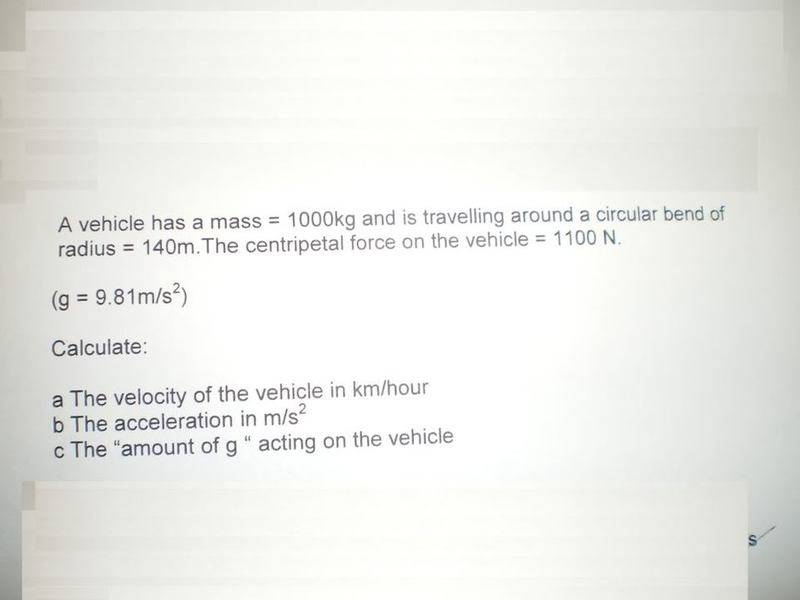

Velocity =2PiR/T
Time=2PiR/V
Force Centripetal = MV^2/R
Angular Displacement/Time interval = Average Angular Velocity
Angular Velocity x Radius Of Circle Path = Linear Velocity
Average Angular Acceleration = Change In Angular Acceleration/ Time Interval
Linear Acceleration = Radius of Circular Path x Angular acceleration
Force= Mass x Acceleration
How do i calculate time? Once i know that i can use this formula: Velocity =2PiR/T
Is T(Time) = 360 radians?
Im not honestly sure where to start, I've been trying for 4 days now, constantly seeking infomation while at work.

Wouldn't it perhaps be easier to use a different formula, one in which you know all the required information?

What do you mean.
1) Transpose the equation again
or
2) Theres another formula that i have missed
If so, any hint on where to look.

The formula is on your list :wink:. You know the centripetal force, the mass and the radius. You want to know the velocity.
I so hope this is correct.
Fc= MV^2/R -> Fc x R/M=V^2
Velocity -> (1100x140)/1000 = 154^2 -> [tex]\sqrt{154}[/tex] = 12.4 (m/s ?)
Acceleration -> V^2/R -> 12.4^2/140 -> 1.09 m/s^2
Force Gravity -> M x g -> 1000x9.81 = 9810g

I'm not checking your arithmetic, but your method looks good :approve:

I'm guessing by the amount of g acting on the car, they mean how many times the acceleration due to gravity is the acceleration of the car, rather than the actual force. Do you follow?
Would i be correct in saying that:
Acceleration x Gravity = The amount of g acting on the vehicle?
1.09 m/s^2 x 9.81 = 10.69
Not quite. If you accelerate at 1g means you are accelerating at a rate that is equal to the acceleration due to gravity (i.e. 9.81 m.s-2). Similarly, an acceleration of 2g is equivalent to an acceleration of twice that of gravity (i.e. 19.62 m.s-2). That number of g's 'pulled' can be calculated thus:
[tex]n = \frac{a}{g}[/tex]
Do you follow?
Ok that would mean that.
Acceleration / Gravity = The amount of g acting on the vehicle
1.09 m/s^2 / 9.81 = 0.1 (g)
Looks okay to me :approve:
