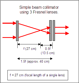

Ah, I forgot about combining 2 lenses to make an effective lens of half the focal length. That suggests the attached setup, where the beam size is reduced to half it's width. This makes for 4 times the intensity of the original beam, neglecting losses due to transmission and aberations.
