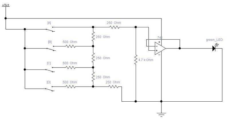

Ok, so something more like this schematic?
My testing bench is telling me that with the R2R later setup this way, the mA coming out the output (heading to the LED) changes depending on which I/O port (A-D) is currenlty on. I'm not real sure if this is the case, or if it's just this very old and wonky workbench I use. But this seems right though? If the OpAmp can output 100mA, then as the voltage changes on its input (from the R2R ladder), the output of the OpAmp will be that set voltage at 100mA maximum. Am I understanding this right?

Close, but not quite right. You need a 2R out of each IO, including the MSB IO, and 2R to GND. There is no resistor out of the top node going into the opamp.
Also, I don't think the "741" will source any 100mA on its own -- most jellybean opamps are more like 10mA output. You can increase the output pullup current by putting an NPN transistor at the opamp output, and closing the feedback around the emitter/output of the transistor.

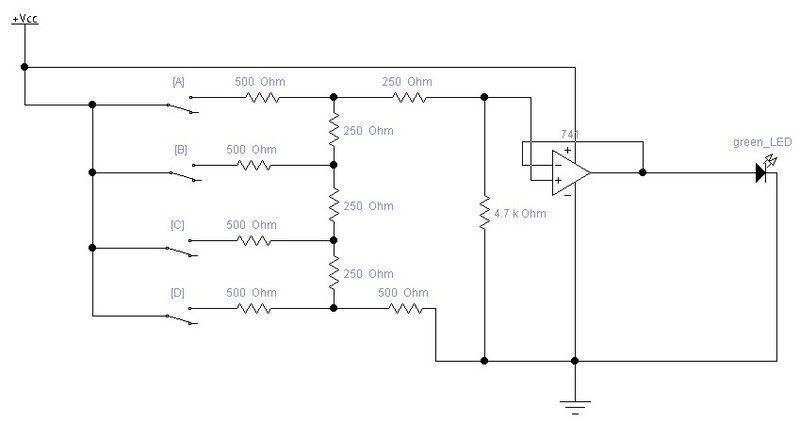

One last try! The 741 is just what the workbench put there (it's from 1997). I'm actually looking at a MIC7111 OpAmp (25uA Supply to 100mA Current Output at 1.8V to 11V) for use in it. I apologize if this has been annoying for you, but I appreciate the responses. I've been doing some home-made EE for years, but haven't used many components other then IC's and other small things, R2R ladders and OpAmps have never been needed before.

No annoyance at all, happy to help. The 250 Ohm output resistor and the 4.7kOhm pulldown resistor aren't really needed, unless you have something in mind. The R2R ladder DAC and opamp follower are the basic parts of the circuit. The R2R ladder provides the pulldown funcion when all IOs are off, and the 250 Ohm resistor between the ladder and the opamp doesn't really do anything that I see, since the opamp input Z is so high.
Now build up that puppy and test it out! :biggrin:
I think the 250 Ohm output resistor was a left-over when I was trying something out so that one can easily be taken out. I wasn't sure if a pulldown was needed so I threw one in anyways, so again, easily removed (didn't notice the R2R was performing the same funciton as it as you point out). I think I'll fire up my PCB editor and see if I can get this board layout setup, then go hit the hardware store locally and do some bread-board testing just to make sure everything works the way I have in mind.
Thank you very much berk, I appreciate it! I'll let you know how it works when I get the sucker built!
Good stuff. BTW, I just noticed that you don't have a resistor shown in series with the LED to limit the current (unless you're using an LED with a built-in resistor). Remember that the LED will drop about 2V, so size your resistor to give you the current range you want. Also, I didn't check the datasheet for the opamp you mentioned, but keep in mind that many opamps (especially older ones) cannot have the inputs go to the rails, and generally cannot drive the output to the rails. So you often power the opamp from wider rails than the 5V (or 3.3V) of your uC. Check your opamp datasheet and look for the "Input Common-Mode Range" spec, and the output drive level spec.
