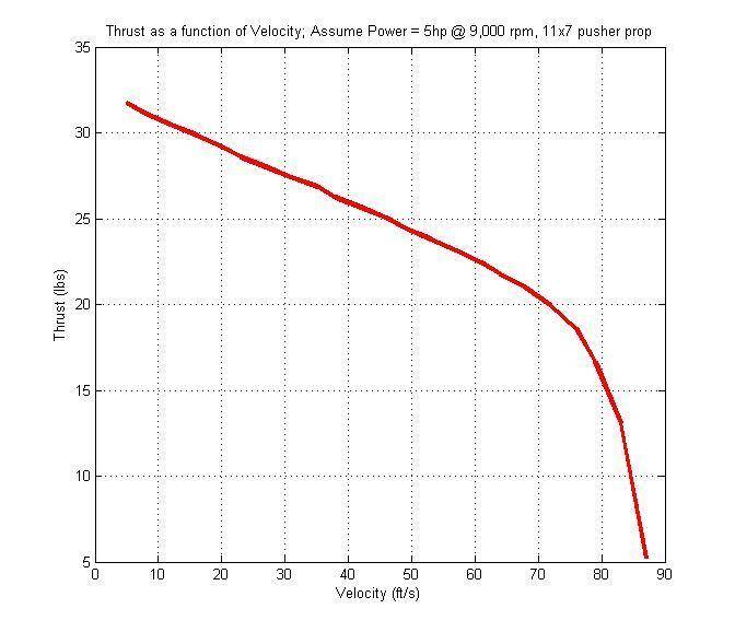

The following are a few questions that i have come across while writing takeoff distance code:
1. Assuming a known static thrust, how will this thrust vary as the airspeed increases?
ex. Is the relationship linear? quadratic? how can i determine the coefficients of the "thrust in terms of velocity equation"?
2. Assuming i know my engine power output at given rpm, and given some known prop parametrs. What program/website contains the equations needed to find the static thrust output?
3. Does anyone know of some good Take Off Distance Calculators that i can use as a sanity check for my code?

Yes i found a good chapter in the following book describing what i wanted:
Propeller Theory and Applications in the book "Airplane Aerodynamics and Performance" (Roskam)
The problem is that the geometry of the propeller and in particular the integrated design lift coefficient ( CLi) and blade activity factor ( AF ) must be known to analytically solve for static thrust and thrust at any given airspeed.
In my case i am working on sizing a roughly 40 lbs UAV and will be using R/C props, which as far as i can tell do not have these required parameters readily provided so what i am doing is assuming a linear thrust profile starting from the static thrust and decreasing at about (1 ft/s every dv = 30 ft/s ) this is based on the output of some "prop calculators" available online. This set-up is numerically iterated for a range of thrust values in MATLAB and a curve has been generated.
To determine the static thrust, I would use the following [tex]Eq^n[/tex]:
[tex]T=\frac{c_T}{c_p}\frac{P}{nD}[/tex]
Where:
P = power (ft-lb/s or kWW)
T = Thrust (lb or kN)
D = Prop Diameter (ft or m)
n = rotation speed (rev/s)
[tex]c_P[/tex] = Power coefficient
[tex]c_T[/tex] = Thrust coefficient
And:
[tex]c_P=\frac{P}{\rho n^3 D^5}[/tex]
[tex]c_T = \frac{T}{\rho n^2 D^4}[/tex]
Given the fact that you can mesaure the power and rpm on your static test stand, you can formulate a curve for the static thrust vs. rpm data you are collecting and compare the theoretical value to your measure value if you place a scale on the bottom of your test stand to measure the thrust.
It would be interesting to see how close the two come to each other.
Source: Aircraft Design: R.P. Raymer p. 393-400

Thank you for your reply, the information has been very helpful, I've also received some additional data from the prop manufacturer that i can use as a sanity check.
Cyrus,
i used the equations in your first reply because the manufacturer provided me with the related data.
attached is an output for Thrust vs Velocity, it seems pretty reasonable to me.
woleka said:
Cyrus,
Which reply? I don't have any equations in my first reply so I don't know how you are coming up with this curve.
I meant 3rd, sorry.
woleka said:
I meant 3rd, sorry.
But that was for static thrust. You used the wrong equation then. You should have used the one #9.
