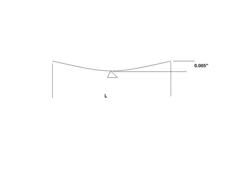

Hey Guys,
I am working on a situation where I have a beam that is simply supported in the middle, and the two ends of the beam are .005" higher than the middle where the support sits. I am trying to figure out with a linearly increasing load what the force is to make the two ends ,which are sitting .005" higher, the same heigh as the middle. Basically I want to flatten the piece.

Are both ends inclined? (Engineers love drawings so make one)
Yes both ends are inclined. They are 0.005" higher than where the support it

You are confusing me with what you term a "linear increasing load." It looks like in one case you mean a simple distributed load and the other you are doing a distributed load that is a function of the distance down the length of the beam, i.e. a triangular shaped distributed load. I understand what you are doing and as a rough first guess I would have done what you did. What I don't understand is the second part you are comparing to.
Yeah by linearly increasing load I mean a triangular distributed load that is increasing the further away from the support you get.
So in the first part I have the load required for the triangular distributed load
and then I found the resultant force of that triangular distributed load by using the formula
.5*L*load. Load being in the form of (lbf/in)
When I compare the pressure from the triangular distributed load and the pressure from the resultant forces, I get two different pressures.
If you have triangular loads which increase towards the free ends on both sides of the middle support, then you have the equivalent of a cantilever with half the length.
