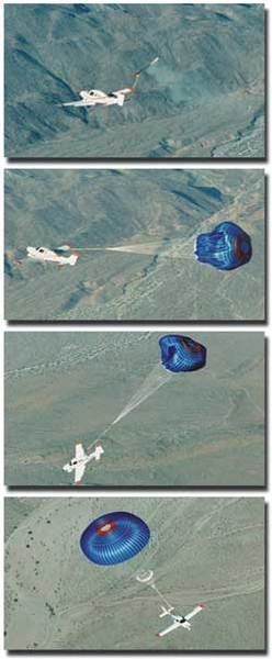

KELOWNA -- A high-tech parachute unfurled from a special gap in the fuselage of small plane hurtling to the ground this week, carrying the aircraft down safely and saving the lives of four Alberta residents...
...The plane, a Cirrus aircraft, started spiralling out of control after taking off from a refuelling stop in Kelowna Thursday night.[continued]
http://www.theglobeandmail.com/servlet/ArticleNews/TPStory/LAC/20040410/PLANE10/TPNational/Canada
The pilot of a small disabled, single-engine airplane, which floated to a safe landing instead of crashing, can thank NASA and a Minnesota company. The pilot walked away, from what would have been a catastrophic crash, with just a stiff neck...[continued]
http://spaceflightnow.com/news/n0211/22parachute/
