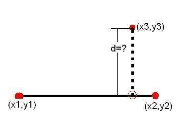

Hi ,
I have drawn a line between two co-ordinates say (x1,y1) and (x2,y2). I have a point called (x3,y3) . From the point (x3,y3) i need to draw a perpendicular line to (x1,y1) and (x2,y2). so that i will be able to find the perpendicular distance . Is there any formula for calculating or drawing this perpendicular line. Any equations for finding this? I have depicted the question in terms of diagram which is attached along with this message.
pls help.
Thanks in advance

The slope of the line from (x1,y1) to (x2,y2) is m= (y2-y1)/(x2-x1). The slope of a line perpendicular to that is -1/m (the slopes of two perpendicular lines always have a product of -1). Finally, the line through (x3,y3) with slope -1/m is y= -1/m(x- x3)+ y3.

Thanks for the very prompt response. Will you please brief with one small example ? I am sorry and i am not much good in mathematics. your help will be greatly appreciated.

An example: Let (x1,y1)= (1, 1), (x2,y2)= (5,3) and (x3,31)= (0,3). (Made up pretty much at random.)
The slope of the line through (1,1) and (5,3) is (3-1)/(5-1)= 2/4= 1/2. (In fact, it is easy to see that the line through those two points is given by y= (1/2)(x-1)+ 1.)
The slope of any line perpendicular to that is -2 (since -2(1/2)= 1). The line with slope -2 passing through (0,3) is y= -2(x-0)+ 3 or y= -2x+ 3.
To find the "perpendicular distance" you would now find the point where the two lines y= y= (1/2)(x-1)+ 1= (1/2)x+ 1/2 and y= -2x+ 3 intersect. That gives, of course, (1/2)x+ 1/2= -2x+ 3 or (2+ 1/2)x= 3- 1/2. That is, (5/2)x= 5/2 so x= 1 and then y= 1 (I swear! I picked the numbers "at random"!) Finally, the distance from (0,3) to (1,1) (the intersection) is sqrt(12+ 22)= sqrt(5).
