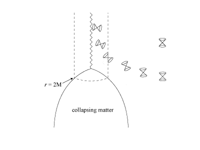

Why would it be a genuine miracle? The absolute horizon is defined in terms of whether light from an event emitted at one point will in the future escape to infinity or hit the singularity--why should it be surprising that this depends on what happens to the matter falling into the black hole in the future? Again, I think this is Thorne's point when he writes "The very definition of the absolute horizon depends on what will happen in the future: on whether or not signals will ultimately escape to the distant Universe." And keep in mind it's not like there's any physical way to measure the position of the absolute horizon at a given moment and thus gain information about the future, you can only reconstruct the position of this theoretical entity in retrospect.
Thorne provides a diagram on p. 415 of both the apparent horizon and the absolute horizon of a star collapsing into a black hole. The apparent horizon does not "switch on" until the entire star has shrunk to the Swarzschild radius for its mass, like the image http://people.bu.edu/pbokulic/blackholes/:
On the other hand, the absolute horizon actually appears in the center of the star before the star has shrunk to the Schwarzschild radius, and grows outward until it meets the surface of the star at the star's Schwarzschild radius, like the pink line in the diagram here (the outer blue lines represent the outer edge of the collapsing star):
Assuming they are modeling a star of uniform density collapsing--and I think that's normally the simple model that would be used--then the absolute horizon inside the star at a time before the moment the apparent horizon forms should enclose a collection of mass with a lower density than the density of the star at the moment the apparent horizon forms. But smaller black holes are supposed to have a higher average density inside (mass/volume) than larger black holes. So this also suggests to me that the absolute horizon is only appearing inside the star because of what will happen in the future--if the star were actually made of a huge collection of tiny rockets, then at any time before the apparent horizon forms I think all the rockets could fire and the whole collection could avoid forming a black hole, in which case no absolute horizon would ever form.

Your reasoning about the density is good but you appear to be locked into thinking in terms of the well known exterior Schwarzschild solution rather than the interior Schwarzschild solution that is applicable in this case. The average density of the expanding 'inner black hole' is indeed less than an isolated black hole of the same radius without the outer unenclosed mass, but the absolute horizon is not determined purely by the mass within its enclosing radius but by all the mass involved.
If you draw a horizontal line just after the absolute horizon forms you will find that its radius is completely determined by all the mass and its distrubution at that instant (defined by the horizontal line.

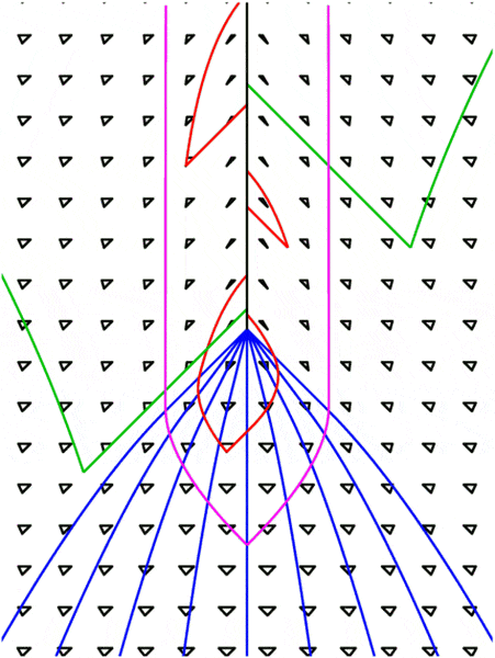

OK, I given this some more thought.
The diagram posted by JesseM would seem not to be to scale. To a first order aproximation using a static solution the absolute event horizon does not appear until the the mass is enclosed with a radius of 9/8 Rs where as the diagram shows the absolute event horizon appearing much earlier when the total mass is enclosed with a radius of about 2 Rs. The situation shown is dynamic and presumably (if we assume gravity is communicated at the speed of light) the absolute horizon would not appear at the centre until the mass is enclosed well within 9/8 Rs.
The diagram comes from Ned Wright's Cosmology website and the accompanying text states "The coordinates used in this diagram are the Kerr metric coordinates for times later than the creation of the singularity. The Kerr metric describes a rotating black hole, but the rotation is set to zero here. Before the creation of the singularity a simple analytic form is used instead of the exact solution for a collapsing sphere of pressureless matter."
One odd thing about that statement is that he says he uses the Kerr metric with the rotation set to zero. The Kerr metric with rotation set to zero is the Schwarzschild metric so why not use that in the first place? There are variables for motion of the test particle and the angular momentum of the gravitational body in the Kerr metric, but there are no variables for the change in mass or change in density of the gravitational body in the Kerr metric so the Kerr metric is radially static just like the Schwarzschild metric.
He then adds that for the creation of the singularity he uses a method that is not an exact solution.. Is it safe to conclude that super luminal effects and that a black hole can effectively read minds on the basis of a non-exact solution?
The correct approach is to use a Kerr-Vaidya type metric that is dynamic rather than static with the angular momentum set to zero to simplify things.

Part of the diagram produced by Ned Wright has been produced using a "non-rotating Kerr metric" which is effectively a (static) Shwarzchild metric. Ned clearly shows light paths entering the event horizon as straight diagonal lines and that is not true for a Schwarzschild metric and he is clearly using some form of Eddington-Finkelstein coordinate system, so that is an inconsistency in his diagram.
