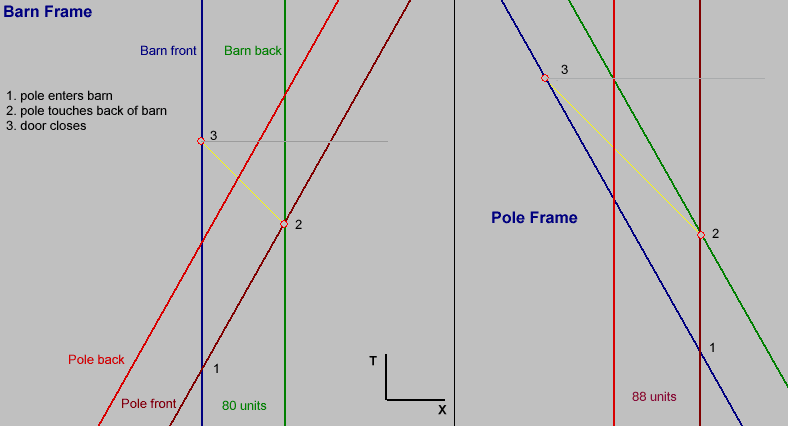

These two diagrams are accurately plotted. The pole is 88 units long and the barn 80 units when at rest wrt each other. The pole is rushed into the barn and touches a switch at the back which sends a ray of light to the front of the barn to close the door.
The observer in the barn sees the pole half-in and half-out when the front door closes, but the observer with the pole sees the whole pole through the garage. I trust this diagram, and hope I haven't made a mistake.
