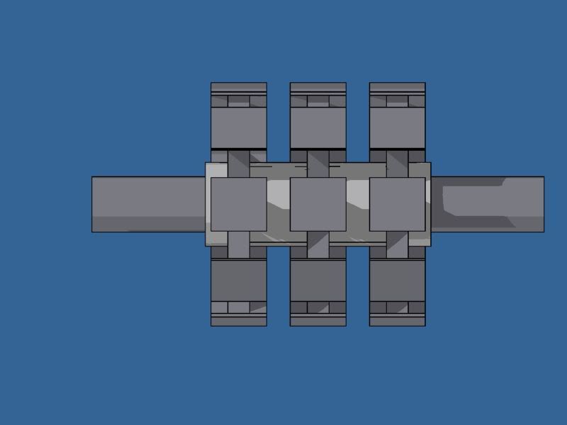

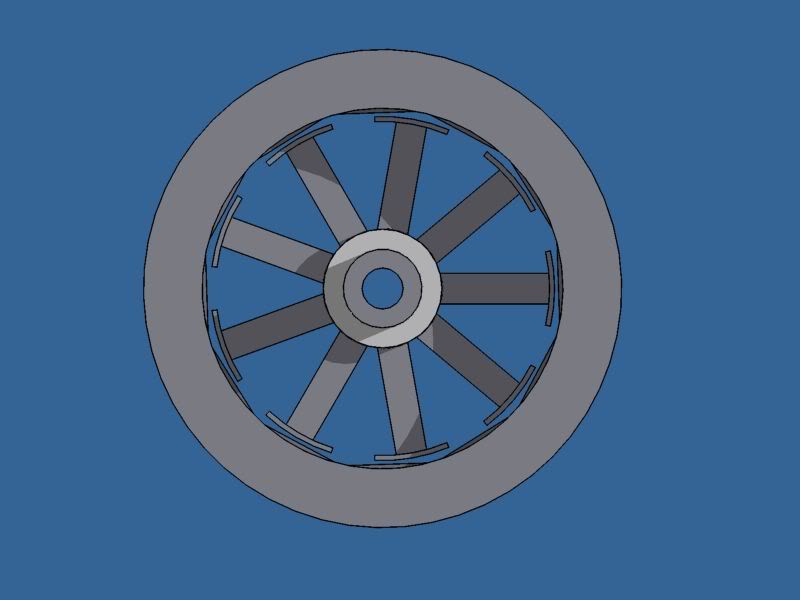

Here are 2 diagrams
And dimensions:
Rotor
Outside Diameter: 3"
Inner Diameter: 2.25"
12 magnets embedded into Stator 0.125"
Stator Axle
Inner Diameter: .25" ;
2 Inner Diameter: .5"
Outer Diameter: 0.75"
Length: 2" ( to allgin with magnets)
Stator
length of Armature: 0.675" ( can be adjusted slightly if neccesary)
Thickness of plate at end of the Armature: 1 mm ( might need to correct)
core thickness: square crosssectional: (.2" x .2" )
Round Crosssectional ( radius .15")( not sure which core shape id want, most likey the round cross section
Magnets embedded into the Rotor ( l*w*h) : 2" x .5" x .125") N40 grade Neodymium magnets
