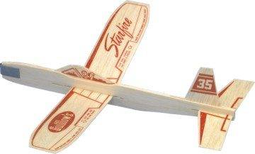

Just an fyi, even a flat plate will fly if it has a positive angle of attack...but I don't think anyone has ever tried to fly one. Even the Wright Flyer had a real airfoil.

russ_watters said:
A flat plate will fly if it has a positive angle of attack.
The old "dime store" type balsa gliders have flat wings and glide just fine. Rubber powered balsa planes with flat wings also fly well.
http://www.retroplanet.com/PROD/24887
http://www.retroplanet.com/PROD/24886
