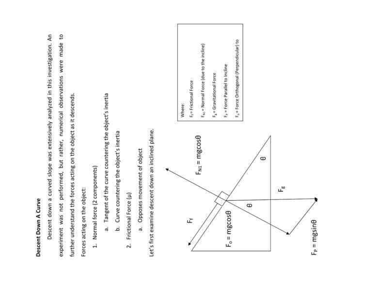

This is what my partner has came up with so far. But I can't seem to understand it and there are some parts that just appear from nowhere. I would've approached it a bit differently but I'm not sure if I'm right. So can you please look at this and tell me if it makes any sense?

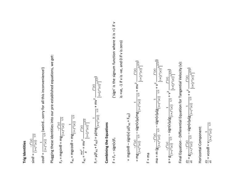

I'm not completely sure of the correctness of this. I lose understanding right where it starts talking about the second portion of the normal force. From what I understand, the whole curve can be taken as a combination of tiny pieces of straight edges that have a certain slope (the derivative of the function of the curve). So the overall force at anyone point can be calculated by adding up the different forces in the freebody(-ish) diagram.
Q1. The second normal force (FN,2) is what throws me off (and the rest of the sin and cos stuff with derivatives). The equation of that normal force is given as FN,2 = mv2/R
That looks awfully like the centripetal force equation for a circle with radius R. But in this case where is the circle? I originally thought that other force would consist of the inertia force from the previous "piece" of the curve, but I have no idea how to express that in terms of math. Is this correct at all?
Q2. The "trig identities" on page 3, I have never seen those identities in my life and my partner refuses to explain where she got them from. Are they correct at all? I just get completely lost from that point on...
Yes, FN,2 is the "centripetal force", mv2/R.
Here, R is the radius of curvature of the curve at that point … the radius of the circle that most closely fits the curve.
However, I think most members of PF would strongly disagree with calling it a force (your book calls it the "second normal force") … it's really the mass times the centripetal acceleration, and comes on the RHS of F = ma, not the LHS …
btw, this is a matter of geometry, not physics … if an object goes at speed v along a curve with radius of curvature R, then its acceleration is automatically v2/R
Yes, as I said, it isn't part of the normal force (except possibly for a frame of reference moving with the object, for which fictitious forces such as this have to be invented so that Newton's first law still works)
The tangent of the slope of the curve, tanθ, is dy/dx, ie f'(x).
The line-element is ds = dx√(1 + (dy/dx)2) = dx√(1 + (f'(x))2) (so distance along the curve is ∫ds = ∫dx√(1 + (f'(x))2))
(there's some "squareds" missing in your formulas :frown:)
(and so sinθ = dx/ds and cosθ = dy/ds)
