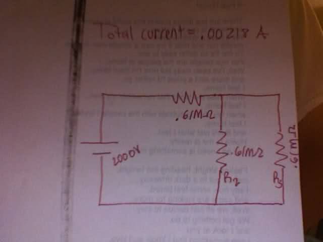

In the circuit of the figure below, script e = 2.0 kV, C = 7.0 µF, R1 = R2 = R3 = 0.61 MΩ. With C completely uncharged, switch S is suddenly closed (at t = 0).
(a) At t = 0, what is current i1 in resistor 1?
(b) At t = 0, what is current i2 in resistor 2?
(c) At t = 0, what is current i3 in resistor 3?
Repeat for t = infinity (that is, after many time constants.)

AT t=0, the capacitor is uncharged so treat the capacitor as if it was just a wire. Then you just have a simple circuit with resistors only.
At t=infinity, there is no current in the section containing the capacitor (so no current in R3)
You just have a simple circuit with the battery connected with R1 and R2 in series.
The voltage across the capacitor is the same as the voltage across R2

You would use series and parallel combinations of resistors to calculate current flows. As nrqed hinted, when the switch is first closed, the capacitor acts like a short circuit. So re-draw the circuit using that hint for the first set of questions.
For t = infinity, the voltages have all reached equilibrium, and there is no current flow through the capacitor (looks like an open circuit). Re-draw the circuit for this case, and answer the second set of questions.

Ok thanks, I drew the equivalent circuit for part 1 and got the total current. I then got the voltage across R1. But I'm having loads of trouble finding the voltage across the two parallel resistors. Any suggestions?
What does the equivalent circuit look like? What did you get for the total current. What did you get for the voltage across R1? And so the voltage across the parallel resistors would be... what?
That's the complete circuit.
The total current is .00218
The voltage across R1 is 1322.85V
I don't know what to do with the parallel resistors.
The equivalent resistance of the two parallel resistors is .305Mohm

How did you get the total current and V(R1)? You would have had to deal with the parallel resistors to get those answers, right? What do the voltage drops have to total up to equal when you add up all the drops around a closed loop?
I know the voltage drops add up to 2kV. I got the equivalent resistance of the two parallel resistors as .305Mohms. I got the todal resistance by finding the equivalent resistance of the entire circuit by adding the resistors in series and parallel. Then to get the total current I used ohm's law(V=IR) to get the total current.
I know the current at R1 has to be the same as the total current, but I am having serious trouble finding the current between the two separate parallel resistors.
The voltage drop across the two parallel resistors is just what is left over after you subtract V(R1) from the source voltage of 2kV. The voltage is the same across both of them. Then, since you have the voltage across them, you can calculate the current through each if needed. Make sense?
Thanks so much! Yeah I had all the numbers i just wasn't doing the math right. Let's hope i can do this for the T=infinity lol.
