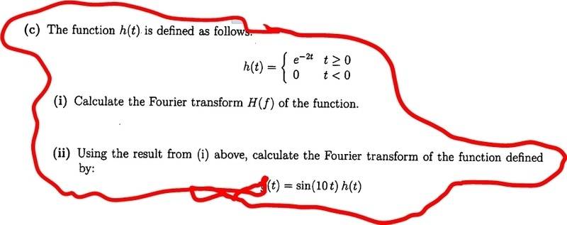

Hi all,
Can some1 explain how to get the complex Fourier transform of sin(10t)
I understand how to steal it off a Fourier transform table, but i have no idea how to do it manually.
Any help anyone?
The Fourier transform of a pure tone (the sine function) is two delta function, one at [tex]+\frac{10}{2\pi}[/tex] and the other at [tex]-\frac{10}{2\pi}[/tex] (I could have my [tex]{2\pi}[/tex]'s wrong). The last part of this question should be a simple sampling in the frequency domain of the transform of the function in part A.
thanks for your reply.
yeah i was way off. Thanks for the clarification

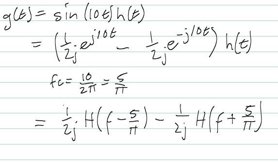

Hi,
When answering question above, you stated the need "The last part of this question should be a simple sampling in the frequency domain of the transform of the function in part A."
I believe i have the right rule attached.
e^(j 2pi fc t)g(t) <-> G(f-fc) (this formula is attached in jpeg)
So, once i find the Fourier transform of the first function. I simply need to shift it by fc.
I have had a go at it, i think its right. (answer attached)
If you could point me in the right direction, that'd be great. cheers
