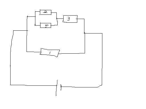

This is the diagram:
https://wug-s.physics.uiuc.edu/cgi/courses/shell/common/showme.pl?cc/DuPage/Phys1202/summer/homework/Ch-21-DC-Circuits/resistor_network/ex1s95p3.gif
R1 = 3W, R2 = 6W, R3 = 11W, R4 =8W, V=6V
A) What is the current through the resistor, R1 in the above circuit? -2A
B) What single, equivalent resistor could replace all of the resistors in this circuit?
C) What is the current supplied by the battery?
D) What is the current through the resistor, R2 ?
1/R (parallel) = 1/R1 + 1/R2 + 1/R3 + 1/R4
R (series) = R1 + R2 + R3 + R4
E = IR
I solved part a. For part be, it seemed to me that R1 and R4 were connected in series, so I combined those two resistors by adding the resistances. Then I added that resistance to R2 and R3 using the equation for parallel resistors.
So, I had: 1/R = (1/11W) + (1/6W) + (1/11W) = 2.87W. This answer is wrong, and I am not sure what to do. Any help would be greatly appreciated :)
Okay, so I solved parts b and c also. Now I am working on part d.
I thought that I2 would = V/R2 = 6/6 = 1, but this is wrong. Any ideas?
Thanks,
Sarah
You need the correct potential drop across the resistor. I'll redraw the circuit for you, convince yourself that the one I have drawn is equivalent. I hope it will then be clearer to you.
Redrawing the circuit into this form is often a good idea when solving such problems. It's now very clear which parts are in parallel, and which are in series.
Thanks,
Sarah
The voltage across R2 is necessarily different from the 6V. Because the voltage at that node between R2||R4 and R3 is determined by 6v * R3 / (R3 + (R2||R4)). Subtract that from 6v to give the drop across R2. With that voltage drop divided by R2 you should have I through R2.
