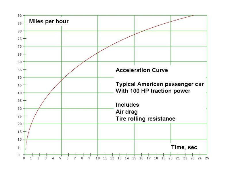

The attached thumbnail shows the calculated maximum acceleration speed vs. time for a typical U.S. passenger car. This plot includes air drag and tire rolling resistance, the two biggest power losses (excepting about 10%-15% typ in automatic transmission). The air drag force is proportional to velocity squared, while the tire rolling resistance force is a constant. Details include:
M=1500 Kg
Frontal area = 3 m2
Air density = 1.2 Kg/m3
Air drag coefficient Cp = 0.32
Tire rolling resistance coefficient = 0.01
Horsepower (traction at axle) = 100 HP, (watts = 74,600)
Net power (HP) = traction power – air drag power – tire rolling resistance power
The acceleration rate = net power /(M•v)
At 30 mph, air drag power = 1,388 watts, tire rolling resistance power = 1,972 watts, net HP = 71,240 watts (95.5 HP), acceleration = 3.54 m/s2, elapsed time = 1.94 s.
At 60 mph; air drag power = 11,107 watts, tire rolling resistance power = 3,946 watts , net HP = 59550 watts (79.8 HP), acceleration = 1.48 m/s2, elapsed time = 8.10 s.
At 90 mph; air drag power = 37,490 watts, tire rolling resistance power = 5,920 watts, net HP (watts) = 31,190 watts (41.8 HP), acceleration = 0.52 m/s2, elapsed time = 23.20 s.
Note that at 90 mph, over half the traction HP is being lost in air drag and tire rolling resistance.
