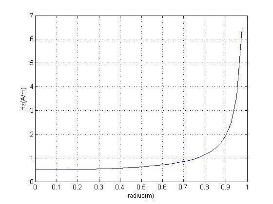

well this shoul calculate the magnetic field of current loop, but i get this error:
? Undefined function or method 'magvector' for input arguments of type
'double'.
Error in ==> test at 43
Rmag=magvector(R);
how can i solve this anyone?
