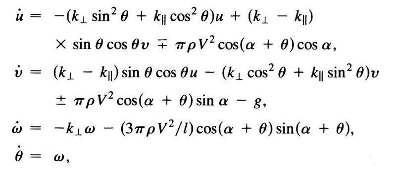

As a high school student I was working on an independent project and at last I found final differential equations that I want to integrate them numerically. I read a little bit and found out that Fourth Order Runge-Kutta Method is one of the good methods. By the way could you please help me to do that. I want to write a C++ program to use numerically integrated numbers to simulate something. So could please help me with that. I mean to integrate these four differential equations preferably in C++.
I give one of the four equations as a sample but all of them are in attachment so please refer to attachment to see them.
Û = -(K1 (sin z)^2 + K2 (cos z)^2 + (K1 - K2) * sin z * cos z u
Please help me or give me some advice about how to start.
Thanks very very much

I guess I'm confused as to what the variables are in your DE's. Is there more than one?
This is an ODE with four dependent variables: u, v, θ, and ω. There is but one independent variable: Time.
Let me talk about that project maybe it can help you to really understand what I want to do. I want to mention this is not an school project or related to anything only I became interested in it so I wanted to do some works on it because I really love physics. I became interested in motion of falling papers and leaves so first I did many experiments to conclude some statistics data about fluttering and tumbling in their motion and how are they occur. After that I read some papers about visualizing it so I thought that it is a good idea to do it myself too. I mean I wanted to use the simplified equations that Tanabe and Kaneko used in their paper. So I want to use the equations from their paper. I know what ODEs are and I can solve basic ones too but I am not really mathematically comfortable with the final differential equations that I want to integrate them numerically as their mentioned in their paper.
I attache the paper that I am specifically interested into this reply. I will appreciate if someone can guide me through this process.
