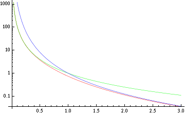

I made a little graph to show the magnetic force dropoff from a dipole, as you start from one pole and move off to the side. The red line is the actual dipole force, the green line is 1/r^2, and the blue one is 1/r^3, and you can see that the red line starts out following the green line then "moves over" to the blue line. As I said, it's a gradual transition, but the center of sorts is at r=1 on the graph, which represents the length of the dipole. So if the two poles are a distance d apart, roughly speaking, the force is like 1/r^2 if you're closer than d, and like 1/r^3 if you're further away than d.
Technical details: I actually used the formula for an electric dipole,
[tex]\vec{E} = \frac{q}{4\pi\epsilon_0}\left[\left(\frac{1}{x^2}-\frac{x}{(x^2+d^2)^{3/2}}\right)\hat{x} - \frac{d}{(x^2+d^2)^{3/2}}\hat{y}\right][/tex]
but a magnetic dipole behaves the same way with respect to r.

See Diazona's answer in post #11. There's no sharp "boundary" between the near field and the far field. The far-field formula is always an approximation to the true field, which gets better and better as you get further and further away from the dipole.
How far away you have to get before the far-field formula is "good enough," depends on your definition of "good enough."
