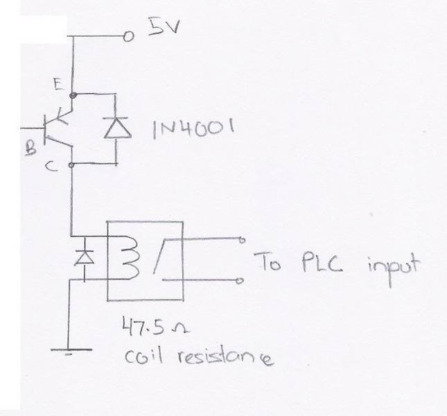

Hi,
Anyone here can tell me how to control the saturation voltage of a pnp transistor?
I was actually doing a project and my design using a pnp transistor to energize a 5V relay.Since I am using 5V supply,I can't afford to drop too much voltage at VCE of the transistor.
The design was tested and it worked fine for the past 2 weeks.I was able to get 3.5V at the relay which was enough to energize the 5v relay.
Strangely,the circuit wasnt working yesterday and there was only 0.7V at the relay coil which the VCE of the transistor taking a large chunk of the voltages.
Anyone can advice what could be the reason the VCE suddenly so high?I increase the Ib to 6mA but still couldn't get the VCE down.
Or something wrong with the relay resulting the VCE so high?I tested the relay by directly applying power to it and it worked fine.
Or it could be the transistor itself was damaged and acted strangely.
Please advice.Thank you.

Hi Bob,
I am not really sure if I got what you meant.Refer to the diagram,I put a diode at the CE junction of the transistor.Is this the right way of connecting the diode to the transistor CE junction?

Refer to the circuit diagram,where in my old thread,the CE junction of the transistor is taking all the voltages and there is less than 1V voltage on my 5v power relay.It seems that the transistor was not working.I ordered new transistor and retested the circuit with a diode added at the CE junction.Sadly,it was not working.The relay still did not have enough voltage to energize and most of the voltage was at the CE junction of the transistor.

- The probem is not in the part of the circuit that you posted, it's somewhere else.
- You don't need the CE diode, it does nothing in your circuit. The other diode is needed however.
- What is the part number of the transistor?
- Show the cicuit of the base drive of the transisitor.
- Do your power supplies have (adjustable) current limits?

Hi,
Attached is the full circuit diagram which I use in the testing.
I am using transistor pnp 2N2905A and the ir receiver is TSOP1238 Vishay.
Regarding the power supply,yes it is adjustable.I think it has more than 1A rating.Out of the 4 power supply,only 1 of them can be used to on the relay when the IR receiver was triggered.

I'm sure you know, in an PNP, you have to let the current out of the base in order to turn it on.
you can do a quick test, and simply ground the base with a crocodile click and see if the relay will turn on.
if it does, then the problem is somewhere else.

then in that case, the power supplies have adjustable current limit. somebody was messing around with them earlier and lowered the current limit.
if the power supply is analog, current limit is not hard to find, if it's digital you have to go the menu and find current limit.

Yes,there are 2 knobs at the power supply,one which is the voltage and the other current.
In all my testing and lab work,the lecturer told us to turn the current knob just a little bit.And then turn the voltage knob to the voltage we want.
Are you saying,that I need to turn more on the current knob to raise the current limit.
If that is the case,if I was indeed set a low current limit,and my relay will probably need:
5V/50ohms = 0.1A, then this will result in 4V++ at the CE junction and only 0.7V at the relay coil?

I have no idea what is that for.But I think it limits the output current of the supply.
I measured the relay coil when pnp transistor turns on and it showed 0.7V.
So I = 0.7V/47ohms = 14.9 mA.
Can I say this is the max current that the power supply produced based on the current knob setting?If I turn the knob more,Will I get more current and this increase the voltage at the relay coil and lower the voltage at the CE junction?
Thank you.

Yep, that's the trick. :) It sounds like some of the power supplies simply have the current limits set too low for your circuit.
Basically the current limit is there (on a good lab power supply) to try and help prevent you damaging things if you make a short or other mistake with in your experiment or prototyping exercise. You should always set the current limit before you start working on a given circuit based on the approx maximum current that you expect the circuit will need. In this case I suggest you should set the current limit to approx 200mA.
To set the current limit you should first adjust the voltage to just a few volts and the current limit to near zero. Then apply a short to the supply terminals* and slowly increase the current limit until you get the desired value. Then just remove the short, set your voltage and start your experiment.

Yes,I just did some testing today and everything was running perfectly.It was the current limiter of the power supply that was giving the problem.
