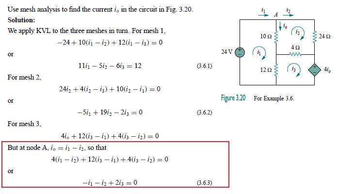

I understand everything up to the point which I've marked in red...
Can anyone explain those few lines?
I would greatly appreciate it!
Thanks.

Seems like KCL (Kirchoff's Current Law) at node A.
i1 = i0 + i2
(sum of currents entering) = (sum of currents leaving)

I understand that part, but how did they derive the equation below that line?

They just substituted into the equation above.

Oh, I see it now. I totally misunderstood the fact that they were simply substituting i0 = i1 - i2 into the third mesh equation.
Thanks :-)
