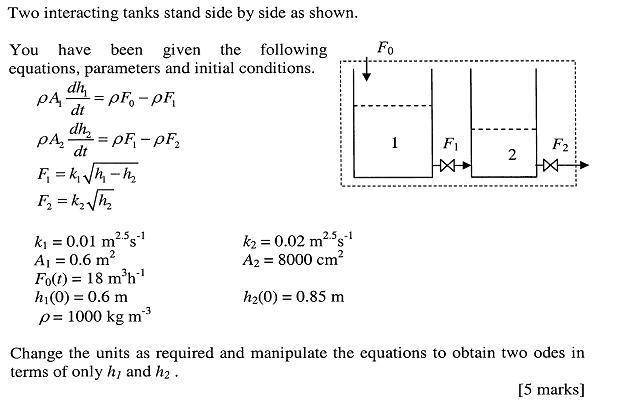

Hi
I'm doing a practice paper for a past mathematical modelling exam. I've attached the problem
What I'm having trouble with is simplifying the equations and variables into a differential equation that is solvable with Euler's Method.
What I have currently is the sqrt(h1-h2) in the equation which leads to an imaginary number so I don't think I have done it correctly. ( As h1<h2..I think the diagram is also misleading)
If someone could help me out with getting the right equation I should(hopefully) be able to do the next part.
Thanks
I'm posting this is another forum as well, need help asap.
P.S the second question doesn't need to be attached, it is:
Use Euler's method to make a single step to predict the levels in both tanks after 5 seconds.

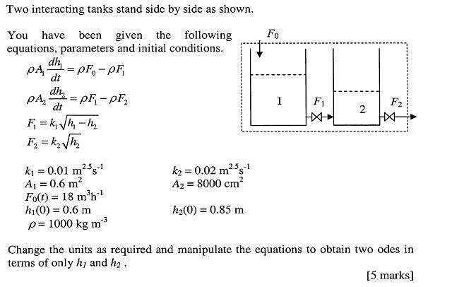

Thanks
I also posted this is the differential equation forum but with only 6 people viewing...

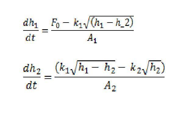

This is what I have but its the square root of a negative number that is confusing me
