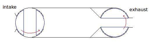

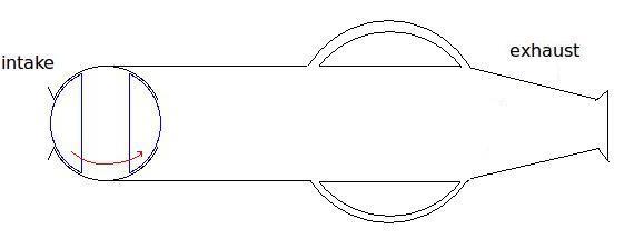

Can I pitch an idea?
Why not have a disc, twice the diameter of the pulse jet. Cut holes in the disc to match the diameter of the pulse jet, leaving a gap of equal diameter between each one.
You can then use a motor and simply spin the disc in time with the combustion cycle - so that at the right times it would either be covered or open as required.
By doing this you remove any problems of stop/start operation. Opening and closing an iris valve quickly is going to have severe mechanical wear, but simply spinning a disc would remove this problem.
Or
Even easier would be to fit a ball valve to the front of the engine (make sure it's one that can do a full 360) and spin it in time with the combustion cycle. Again, it would open / close as appropriate but alleviate as much mechanical stress as possible.

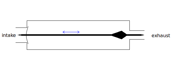

Here's an rough sketch of an idea I had for a dual valve system that might not need mechanical actuators. If done right, I think the changing pressure inside the combustion chamber should be able to move this valve(s) by itself. It wouldn't contain the exhaust before letting it out, but it also doesn't have any extra complexities. Basically a half way point design, I guess. You get some of the advantages without some of the disadvantages.
The inlet portion of the valve has a larger area and so should be affected more by the pressure than the exhaust portion. The increase in pressure do to combustion should shut the inlet, thereby opening the exhaust. Decreased pressure as the exhaust leaves should open the inlet, closing the exhaust. Ram effect should help open the valve in the intake stage.
The question is, will a sufficiently strong vacuum be able to form before the valves switch to intake position...

If you're certain it wouldn't back fire due to the pressure differences created than it may work. Personally I can see it failing due to the way it operates.
The ball valve (or plate rotation idea) wouldn't weigh more than than the iris design if done correctly and should prove significantly more resilient to the operating conditions.
Could you explain?

Refined the design a bit.
I think that the ball valve idea is better than this one, but this would be a nice, simple method of putting two valves in a small, light weight engine. Not sure where there would be applications for it that couldn't be filled by one with ball valves, though.

This is why I mentioned the spinning disc and ball valve - unlike your iris valve there is minimal mechanical stress (well virtually none outside of basic motor wear and tear) and it will be a lot easier to time and power.
Personally I'd go with the ball valve as I could see the disc giving a few issues due to the suction created.

Also, the disc valve would increase the area of the front of the engine and tend to make the engine less aerodynamic, something that isn't usually desirable in a jet engine.

Still,I'm going to work on the ball valve idea. However I am unclear abt the working . First the front valve opens. Then when pressure increases both values close. Next how does the front valve remain close and rear valve alone open.
You clearly have no idea how a ball valve operates. Everything bolded is complete gibberish so far as ball valves go.
Here is an animation that shows how they operate: http://www.opw-ftg.nl/www/pt/europe/products/chemicalindustrial/processvalves/ballvalves/lbv-operation-animation.jsp
You need to have one that can do a full 360 operation and then using that you simply attach and electric motor and then spin it at an RPM that matches the combustion cycle.

I think he may be thinking of a ball in a cage valve, where the ball is loose and can move back and forth a little, opening and closing the valve as it does so.
Nice animation, by the way.

That may have potential, telepresence. It may need a retention spring somewhere. The front valve is a ram--so needs additional thought. The shaft should be larger diameter and hollow for air cooling.
There we go, that's basically what I was going to describe, but I was going to try and explain the 'why' as well - hence waiting for tomorrow.
