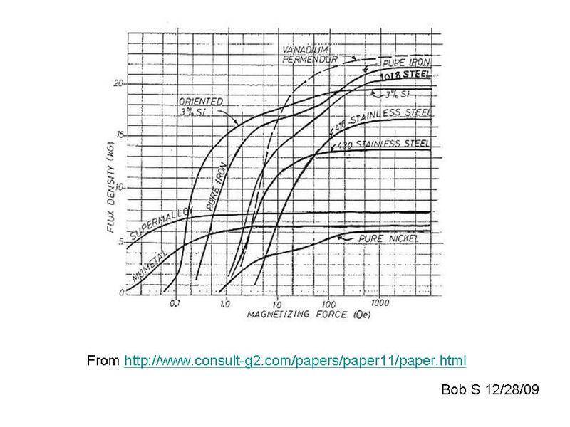

I would like to know a couple of formulas (and simple explanation) of this topic. I am about to have some steel work done, but I need to squeeze a little more B from my magnets. If I want to increase the B of a circular 1"dia 1/8" thick N48 magnet, I would expect to place magnetic steel behind the magnet. I would expect to shield the B on the side I placed the steel, and increase the stregnth of B on the opposite side. How do I know how thick the steel needs to be without being saturated? What kind of increase can I expect?
Also, I know nothing of steel numbers or grades. When ordering, what is the cheapest and also most effective steel for increasing magnet stregnth? This will be a custom job, and I need to know the lingo...
Thanks in advance.
keith03 said:
. If I want to increase the B of a circular 1"dia 1/8" thick N48 magnet, I would expect to place magnetic steel behind the magnet. I would expect to shield the B on the side I placed the steel, and increase the stregnth of B on the opposite side. How do I know how thick the steel needs to be without being saturated? What kind of increase can I expect?.
The first question is easily answered. The area of the N48 magnet is pi R2, where R = 0.5". because the B field is continuous, the steel plate must carry the same flux (B-field times area) as the magnet itself. Soft iron saturates about at 1.2 Tesla, similar to the field from N48. At a radius R = 0.5" on the steel, the circumference times the thickness (2 pi R t) should be the same area as the magnet itself, because the flux in the steel is entirely radial. So we get
2 pi R t = pi R2, or t= R/2 = 1/4" thick.
Look at attached thumbnail of iron and stainless permeabilities. Pure iron followed by 1018 steel are much better than the two 400-series stainless steels shown.
Bob S
