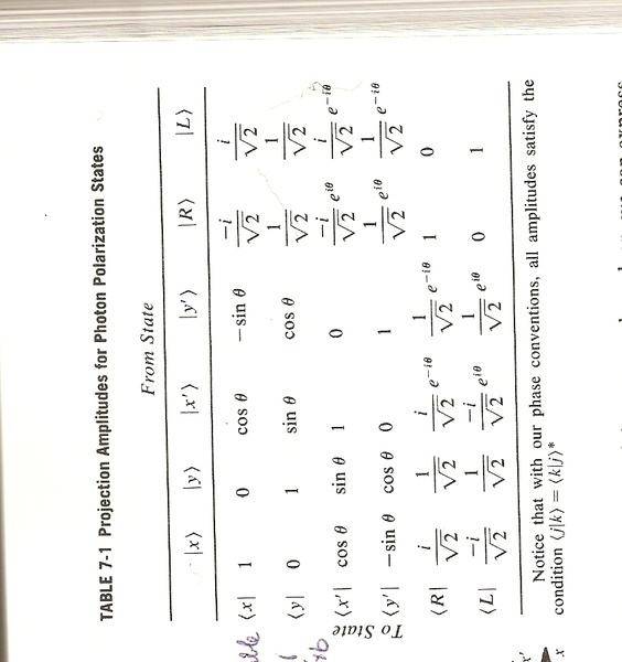

(a) Construct a table of projection amplitudes between these two similar to Table 7-1 (I'll include this table in the attachments) for photon polarization states.
The question continues, but I would like to work the rest out myself. I just don't seem to understand how to change from one base to the other for this question!Thanks for any hints or help you can give me!
