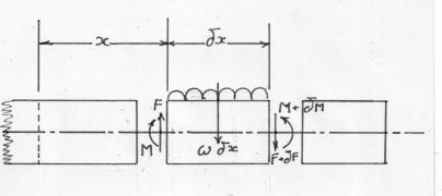

Hi everyone,
I'm struggling to get my head around the convention of internal moments and shear forces of a loaded beam.
I just can't seem to make any sense of why F is facing upwards and F+dF is facing downwards. It's driving me absolutely insane. Surely both of them will be facing upwards to cancel out wdx?
Please help =/
Thank you.
Hi emRage! :smile:
No, the F upward shown on the left of the section matches the F downward (not shown) on the right of the next section to the left (Newton's third law!).
And the next section to the right will similarly have an F + dF upward on its left (not shown), and that matches the F + dF downward shown.
To look at it another way …
the wdx is a very small amount, and tends to zero as dx tends to zero.
It must therefore be "cancelled" by an equally very small amount …
and that isn't going to be the rather large F + F + dF, is it? :wink:

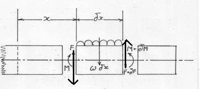

Thank you tiny-tim,
Now my next question is:
The arrows for F and F+dF are facing that way to cancel out the hidden F and F+dF. Why do the (visible) arrows have to face that particular direction? Because if I were to change the direction they are facing, that would change the shear force and bending moment equilibrium eqtns am I correct?
They don't have to.
If you put the arrows that way round, and then solve the equations, you'll find that F will come out negative.
In some problems, it isn't at all obvious which way up they should be, so you just have to make a guess, and if the guess turns out wrong it doesn't matter … you'll have, say, -3N up instead of 3N down … same thing. :smile:
