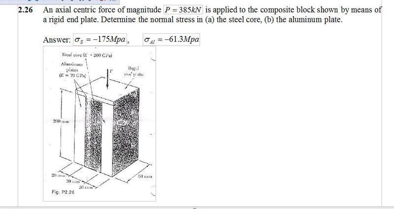

555
now i am looking for the stress [tex]\sigma[/tex] for the aluminium and for the steel
i would want to say simply [tex]\sigma[/tex]=F/A but i need to somehow take into account the types of materials and their elasticity,
i think that hookes law could help me here but i don't know the strains
also how do i take the volume into account? the only equation i have for volume is [tex]\Delta[/tex]=[tex]\epsilon[/tex]x + [tex]\epsilon[/tex]y + [tex]\epsilon[/tex]z, but i doubt that's going to help
You know a little about the strains, since the rigid top plate supplies a constraint on the components' deformation. What can you say about the strain of the steel and aluminum?
Each component will have its own stress, cross-sectional area, and force. Can you relate the forces to the applied load?
i would think that the aluminium and steel have the same strains.
i can find the ratio of forces on each material as their area of the rigid plate? is this correct?
F(Al) = 4P/7
F(Steel)= 3P/7
can i say that since i only have forces on the y axis
[tex]\sigma[/tex]=[tex]\epsilon[/tex]*E
now since the strains are the same
[tex]\sigma[/tex]Al=[tex]\epsilon[/tex]*70*109
[tex]\sigma[/tex]Steel=[tex]\epsilon[/tex]*200*109
now i have t equations and 3 unknowns, but i know
[tex]\sigma[/tex]Al*2*10-3 + [tex]\sigma[/tex]Steel*1.5*10-3=385*103

does that mean that the stress has nothing to do with the height of the element
That's what it looks like.
