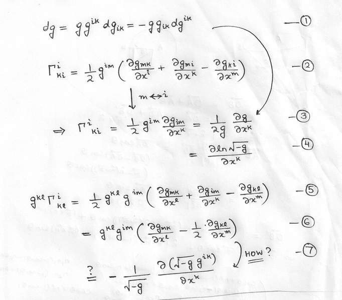

Hi everyone,
I'm trying to work through section 86 of Landau and Lifgarbagez volume 2 (The Classical Theory of Fields).
Basically, I am unable to get equation (86.6) from equations (86.4) and (86.5). I've detailed my working/question in the attached jpg file. I would appreciate any inputs.
Thanks in advance!
Cheers
Vivek

I bet they've calculated [tex]\partial \sqrt{-g} / \partial x^{\mu}[/tex] somewhere.
Take a look at section 1.7 in Eric Poisson's excellent notes,
http://www.physics.uoguelph.ca/poisson/research/agr.pdf.
Better yet, see if your library has a copy of the excellent book, A Relativist's Toolkit: The Mathematics of Black Hole Mechanics, into which the notes evolved.
George, thanks a lot for this very useful link! Unfortunately, my school library does not have this book.
