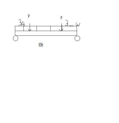

1. Determine the allowable uniform load w if the allowable bending stress is 24ksi and
P=15w
Given: I=12,800in^4; c=16.965in
2. I know that Mmax=[tex]\sigma[/tex]max/c(I); And Mmax=wL[tex]^{2}[/tex]/8
3. I solved for Mmax=18,107.869 k in; but I don't understand how to solve for w with the two P forces also. If someone could help me with this part I would greatly appreciate it. Thanks

some of the moment capacity is used up by the moment of 3P in the central portion of the beam, thus leaving less available for the uniform load. I suggest you first draw the M diagram for the whole beam.
Thats supposed to be a 3ft from P to the edge, sorry my drawing skills are not great. I already did the M diagram that is where i came up the max of 575. I just don't know how to solve for the w.
Maybe you are missing the point that p=15w. Therefore M isn't just wL2/8 but also 36x15w=540w k.in at the centre
O ok, so M would be equal to wL2/8+540w?
Yes, but be careful to use consistent units throughout. Like kip inches, or whatever.
