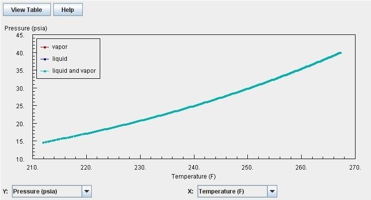

18psi vs 15psi, look up boiling point in a steam table. Mine's at work. I guess something in the region of 5-10 degrees Celsius.

For the boiling point of water vs. temperature, you can generate a chart from the NIST website.
Link to the thermophysical properties page: http://webbook.nist.gov/chemistry/fluid/
Link to a pre-made chart of what you're after, water boiling point w.r.t temp: http://webbook.nist.gov/cgi/fluid.cg...m&RefState=DEF
I attached a screenshot of the chart in case the link doesn't work. Keep in mind the pressure is absolute pressure, so you'll need to subtract 14.7 psi (1atm) to get the gauge pressure rating of a theoretical radiator cap. To put it another way, an 18psi radiator cap plus 14.7psi (atmospheric at sea level) equals 32.7psi absolute.
For a 15psi cap + 14.7psi atmospheric (29.7 absolute): Boiling point is 249.8 fahrenheit
For a 18psi cap + 14.7psi atmospheric (32.7 absolute): Boiling point is 255.4 fahrenheit
EDIT- keep in mind some antifreeze mixtures also modify the boiling point of water. The numbers above are for pure water only.

Thanks Mech Engineer...i think if it gets to 255 weare cooked anyway...but i go some margin to play with..
