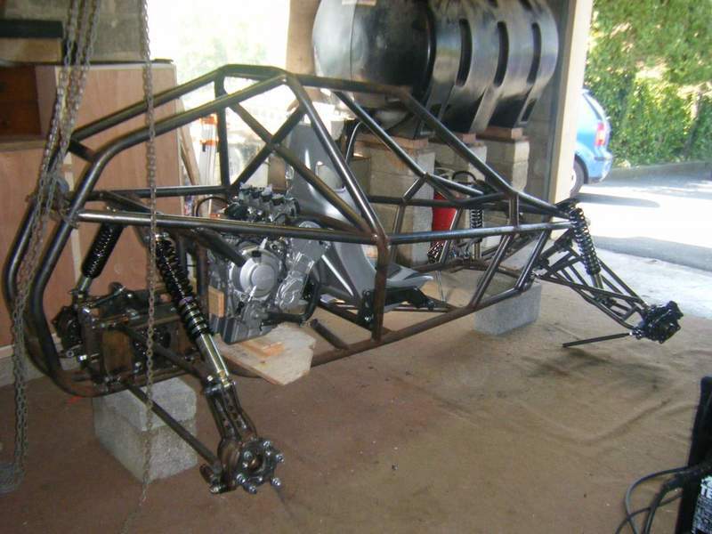

Larkinja or Drankin, any update on your hydrostatic drive project. Like you Larkinja, been playing around with a few projects and I was looking into converting an off-road yamaha r6 engined buggy to a similar hydrostatic drive system...hence I found this thread! Few pics here of what I'm working on.
