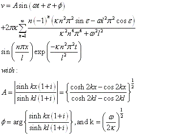

Hi, if you see:
cosh kx (1 + i),
do you consider the (1 + i) to be multiplying the cosh or inside the cosh ?
i.e.
cosh kx (1 + i) = (cosh (kx))*(1 + i)
or
cosh kx (1 + i) = cosh ((kx)*(1 + i))
I saw this in a thermoconductivity bible from the 50's written by a really smart guy, so there must be some standard to this notation. I suspect it is the latter, but need to be 100% sure.

Gonzolo,
Post up the solution ... we should be able to infer from that.

Here is the complete solution. It is pretty heavy.

There we go (a similar problem, slighter simpler, had sinh instead of cosh), the sin()exp() are inside the summation :

Ok ... that's pretty clear.
The writer must mean [itex]\sinh (kx(1 + i))[/itex], rather than [itex]\sinh (kx)\times (1 + i)[/itex], because otherwise, the [itex](1 + i)[/itex] terms in the solution for [itex]A[/itex] would simply cancel.
