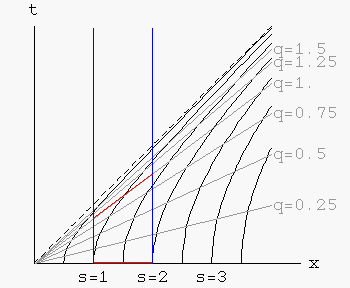

Following the idea I suggested here, I drew in some vertical worldlines whose velocities were tangent to the worldines of some accelerating Rindler observers at t=0 in the inertial frame (which would also correspond to the q=0 simultaneity plane in Rindler coordinates, so the worldlines started out with 0 velocity at a single instant in Rindler coordinates):
Here the blue lines represent worldlines of individual grounds at the "top" and "bottom" of the ball, the red lines connect events on these worldlines which are deemed simultaneous in Rindler coordinates. This diagram seems to show the distance in Rindler coordinates between the top and bottom actually shrinks rather than expands as the ball "falls" in the pseudo-gravitational field, since the first red line at q=0 extends from a middle Rindler observer to that observer's neighbors on either side, but the second red line at q=1 does not reach the simultaneous position of either observer to the side of the middle observer's worldine that the red line crosses through.
edit: Though from the discussion on the page I am not actually sure if the hyperbolas are meant to represent observers who are equally-spaced in Rindler coordinates themselves, it's possible that pairs of neighboring hyperbolas closer to the Rindler horizon have a greater coordinate distance in Rindler coordinates than pairs further from the Rindler horizon...the author doesn't specify if the s=1, s=2 etc. in the diagram actually represent Rindler position coordinates or something else, though this page does seem to indicate that lines of constant time-coordinate in Rindler coordinate look like straight lines that go through the origin as with the lines of constant q in the diagram. Also, Rindler coordinates might be similar to Schwarzschild coordinates in that nearby pairs of observers hovering at constant position coordinate, and with equal coordinate spacing between them, would actually measure a greater ruler distance if they were closer to the horizon than farther away...I know that in terms of ruler distances, it's actually possible to have an infinite series of observers hovering above the black hole horizon with equal distances to their neighbors, though the Schwarzschild coordinate distance between neighbors becomes smaller and smaller as you approach the horizon.
edit 2: scratch that last part, I just realized that since all the accelerating observers are initially at rest in the inertial frame, then if they are equally-spaced in the inertial frame, they'll also be equally-spaced at that moment according to ruler distance in their instantaneous rest frame, and observers at rest in Rindler coordinates have a ruler distance to one another that doesn't change over time.
JesseM said:
...the distance in Rindler coordinates between the top and bottom actually shrinks rather than expands as the ball "falls" in the pseudo-gravitational field...
If I am understanding it correctly, the diagram on the right hand side of entry #13 in this thread
https://www.physicsforums.com/showthread.php?t=251960
is consistent with this conclusion. "..the solid black lines are the worldlines of the inertial Minkowski observers", says Kev. The free-falling objects begin equally spaced from one another, then form hyperbolic secant curves, each asymptotic to the same line - the accelerated observer's event horizon.
