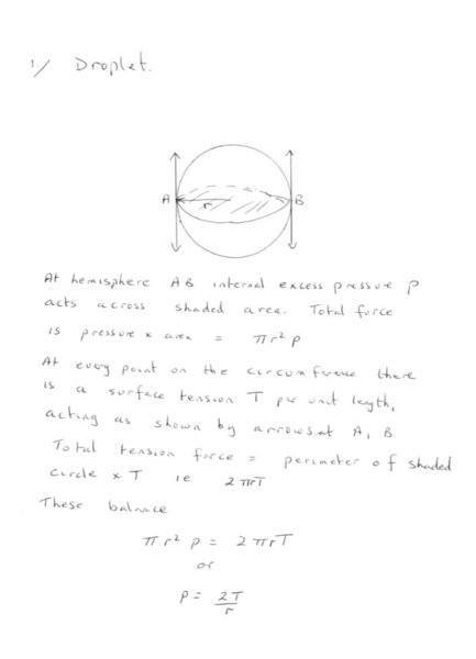

Having complained about the droplet, I am now going to offer you the droplet first, as it is simpler.
There are several ways to analyse the situation, but since you want a force balance here goes.
First the vacuum is a red herring. The pressure inside the droplet is greater than the pressure outside, whether that is atmospheric or non boiling vacuum. I will call the pressure difference p.
The thing to remember is that forces act along a line. Stresses or pressure act over an area.
If you look at the spherical droplet in my sketch you can see that the difference between pressure inside and the pressure on the droplet outside tends to burst the droplet asunder. This tendency is greatest across the greates area ie a diametral disk as shaded.
Opposing this is the hoop force of surface tension. Being tangential at A and B this acts at right angles to the shaded area. I have shown two arrows but, of course this tension acts all the way round the circle which bounds the shaded disk.
The hoop tension acting in the plane of the disk does not participate in the action.
The formula is given in the attachment.
The droplet can exist in free space or air or even stand on a surface.

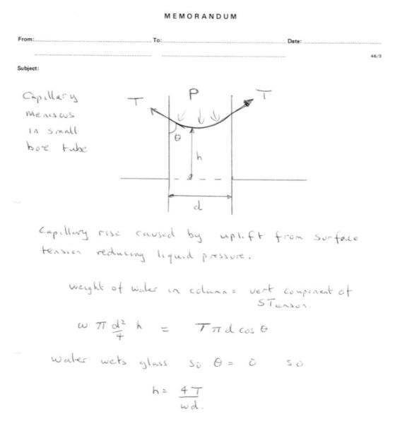

So here is how to work out the forces for a capillary rise.
Can you see how to do a capillary depression?
Also what happens as the walls move apart?

Perhaps I should have said that in the capillary rise example the pressure of the water in the tube is below atmospheric.
So Andy is correct and there is a pressure rise across the surface.
Try imagining that the surface tension causes a drawing up (I don't like to say suction as suction does not exist) of the water by lowering its pressure.
The issue of the beaker was the point of my second question.
When the walls are a long way apart you get two triangles of water at the walls (supported by the vert component of ST) and a long 'flat' surface in between supporting nothing, which is what you would expect, since the sT is horizontal along that surface so has no vertical component.
In a vacuum, though, the pressure in the water cannot be lower than the pressure outside it. that was what puzzled me.
So there would be no meniscus in a vacuum.
Don't forget the atmospheric pressure also acts on the rest of the fluid surface.
So you could say that this pushes up the water in the tube.
I didn't do this but you could also equate the forces to the pressure differential across the meniscus to calculate this pressure drop.
