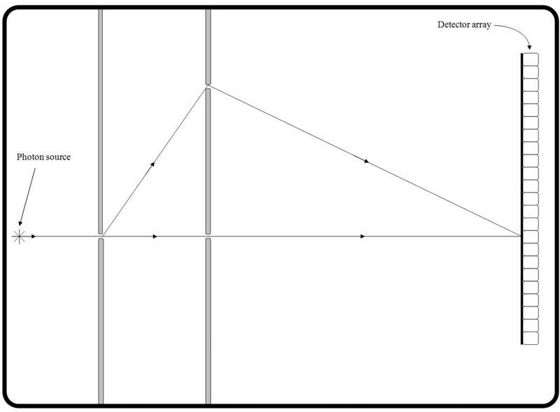

Below is a question (paraphrased) which I addressed to two physics lecturers on the subject of slit diffraction. The problem I have is that answer I received from them sounds so ridiculous and impossible that I find it difficult to accept. I asked the question independently to both lecturers, and their answers were in agreement with each other. Furthermore, both are accomplished, respected, and are expert on this subject; and so I have no reason to doubt the truth of what they say. I would be grateful to hear any thoughts that anybody has on this subject. Anyway, here is the question:
"Suppose that you pass single photons through a standard double slit apparatus one at a time. Over time, a diffraction pattern builds up on the screen, the screen being made up of an array of closely-packed photon detectors. Additionally, you have an accurate clock which is connected both to the photon emitter and to the detection array. When a photon is emitted, the clock starts; when that photon is detected, the clock stops. The two slits are positioned far apart from each other (see diagram), and hence a photon, in passing through one slit or the other, may take either a short path or a long path to the screen. In other words, the photon may spend either a short or a long period of time "in transit" between emission and detection. The purpose of the clock is to observe when a short transit time occurred, and when a long transit time occurred, and hence to provide unambiguously the (retrospective) knowledge of which slit the photon passed through.
Now, isn't it true that in all experiments designed to determine which slit the photon went through, the diffraction pattern is destroyed? That is, no matter how gently and sensitively you try to detect which slit the photon (or electron etc.) goes through, in carrying out this detection you must interfere with the photon slightly, and this interference is what destroys the diffraction pattern somehow? If it is a fact of Nature that one can never both get a diffraction pattern AND tell which slit the photon went through, then what happens in my clock experiment as described above? A clock is passive and does not physically interfere with the photon in any way at all. It merely times the photon's travel time and calculates which slit the photon must have gone through. My question is: By what mechanism does a clock destroy the interference pattern?"
The above is heavily paraphrased but my basic question remains the same. Here is the answer given me by both lecturers: If you switch off the clock, you get a diffraction pattern. If you switch on the clock and collect its timing data, you do not get a diffraction pattern. If you switch on the clock but throw away its timing data as soon as each is collected, you do not get a diffraction pattern. If the clock is switched off, but an advanced robot is present in the room (I began to ask quite desperate questions at this point), and the robot, possessing an accurate internal clock, is able to tell how much time passed between photon emission and detection merely by looking at the experiment, then you do not get a diffraction pattern.
Presumably, then, the diffraction pattern will appear and disappear if the robot opens and closes its eyes? Or if robots sound too far-fetched, presumably the diffraction pattern will appear and disappear as you switch the clock's power supply on and off? This all sounds too ridiculous to be true! What is going on?
The standard answer to that is: Decoherence, i.e. an interaction with the greater environment. The details of how decoherence occurs is however not entirely worked out though.
Note the underlying assumption here: Your detector (in this case a clock) is assumed to work classically, whereas the thing you're detecting is acting quantum-mechanically. But what if your 'detector' consisted of a single quantum-mechanical particle measuring another? Then the result of your 'measurement' would be an entangled state, where the 'subject' particle was both in the state of "being measured" and "not being measured", and the 'detector' would both be in the state of "having measured" and "not having measured". So your 'detector' doesn't 'collapse' the wave function in that case.
So decoherence is the answer to how you get from the latter state of affairs to the former.
To give a hand-waving answer, a macroscopic detector (say, a PMT tube) is in a metastable state. The tiny interaction triggers a much bigger one, sufficiently large to create entropy, which in turn irreversibly 'forces' the system into being in either one state or the other, to an extremely high degree of probability.

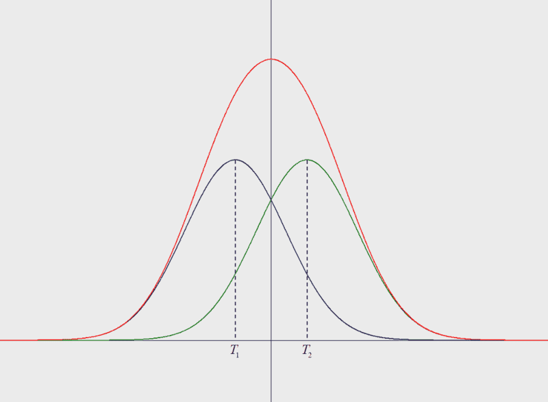

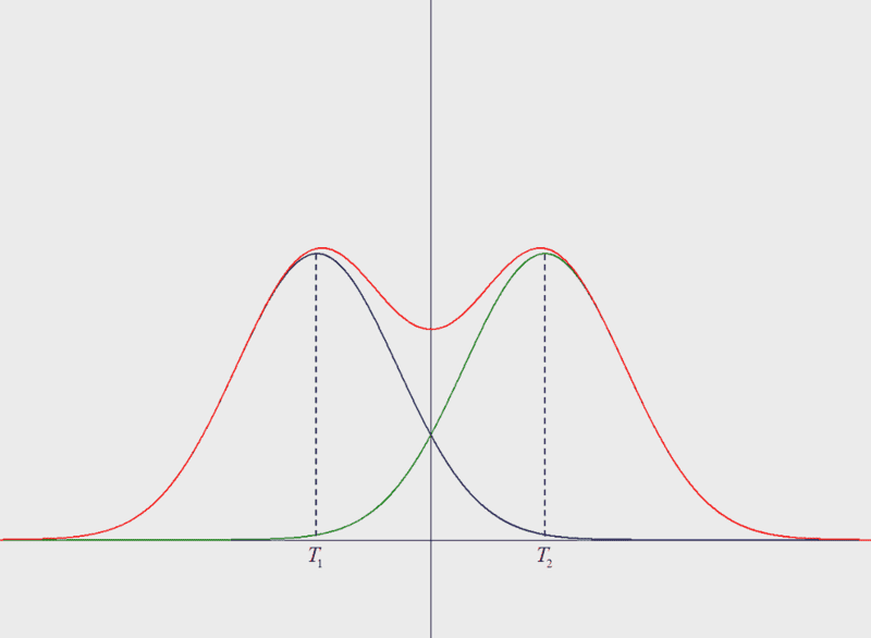

[Let T be the total travel time of a photon between its emission and subsequent detection; let [itex]\delta T[/itex] be the inherent (?) uncertainty on T. Let [itex]\Delta l[/itex] be the difference in length between the long and short paths, with negligible uncertainty on this measurement. (I'm using lower case delta for uncertainties, capital delta for differences.)]
Ok, so the slits/clock experiment is carried out as previously described. Photons are emitted one by one. When a photon chances to be absorbed at the detector, that photon's travel time, T, is recorded and logged. The experiment is run many times. Finally, the results are plotted in the form of a probability distribution: [T] vs. [frequency of T]. (For a single slit I would expect this probability distribution to be roughly Gaussian in shape.)
For each of the two paths, [itex]l_1[/itex] and [itex]l_2[/itex], there is an associated travel time for a photon traversing that path:
[tex]{T_1} = \frac{{{l_1}}}{c}[/tex]
[tex]{T_2} = \frac{{{l_2}}}{c}[/tex]
I would therefore expect the plot to show two (~ Gaussian) probability distributions, tails overlapping, with mean values centred around [itex]T_1[/itex] and [itex]T_2[/itex] (after correcting for skew). However, if two distinct probability distributions are visible in your data then this means that you can determine to a probability >50% which of the two slits a given photon went through. (I.e. you would look at a photon's T-value, and then by consulting your probability distrubtion plot you would be able to say, "Aha, there is a 72% probability that a photon with that particular T value went through slit number 1" (for example).) If [itex]\Delta l[/itex] is made larger and larger then the probability distributions centred around [itex]T_1[/itex] and [itex]T_2[/itex] will get further apart and overlap less and less. The confidence with which you know which slit a photon goes through then approaches 100%. Therefore, as [itex]\Delta l \to \infty[/itex] the interference pattern should wash out and ultimately disappear.
On the other hand, if [itex]\Delta l[/itex] is made smaller and smaller then [itex]T_1[/itex] and [itex]T_2[/itex] start to get very close to each other. Eventually, their probability distributions will overlap so completely that the two distributions will appear as one. Beyond this point it will be impossible to tell from a given photon's T value which slit it went through. In such cases the interference pattern ought to be very strong. I have tried to illustrate this with some diagrams (attached).
So, does the above make sense? If so then I have a related question—which I promise will be the final question!

m.e.t.a. said:
Oh! So it is truly wrong to think about the "crest" of a probability wave as propagating outwards at speed c. Are you saying that you have to consider probability amplitudes for the photon traveling faster and slower than c while it is "in transit" between emission and detection, even though the photon's average speed for the whole journey must be c?
Oh, sorry, Feynman's approach was not what I was thinking about. Although that is another way to put it. You have to consider probability amplitudes for the photon being emitted at different times. My point was rather to consider the width of this outspreading probability wave. The classical particle picture will produce some delta-like peak spreading out from the light source. In a situation which shows interference using a quantum particle picture, this peak will become very broad due to the coherence of the emitter-photon state or equivalently uncertainty in the emission time. If it is broad enough to be nonzero at both slits simultaneously, you get interference. Otherwise you do not.
The explanation is ok, I think.
