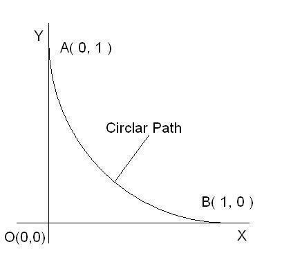

Consider path given by equation [itex]( x - 1 )^2 + ( y - 1 ) ^2 = 1[/itex] that connect the points
A = ( 0 , 1 ) and B = ( 1 , 0 ) in xy plane ( shown in image attached ).

The value of first term after limit substitution is infinity. Here the value of integral i.e. ' time ' should be strictly finite. What is wrong with my solution?

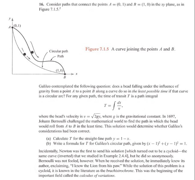

To clear confusion of variable 't' attaching original problem snapshot.
Hurkyl said:
What does t have to do with the curve?
From my understanding of given question it's distance traveled along circular path ( specifically for above problem ) .

i] i generally don't use 't' for distance but given problem follows that notation .
ii] and iii] But we have to calculate transit time T for bead traveling along path given ( part of circle ). The given formula [itex]\sqrt{2gy}[/itex] is valid for any path ( circular, straight line etc ) with same start and end point. Hence, given curve must be parametrized in order to get transit time T along specific path. If we chose the parametrization mentioned by me, then [itex]\Theta = 0[/itex] and [itex]\Theta = \frac{\pi}{2}[/itex] will not leads to co-ordinates A(0,1) and B(1,0).
