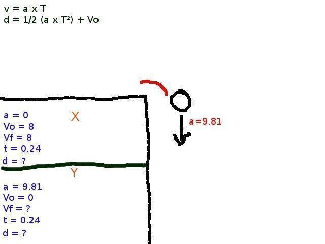

May30-10, 11:12 PM   #69
Conceptual Physics
I corrected
(sorry i'm a little drunk, had problem with my integrals lol)
May30-10, 11:13 PM   #70
its cool,
with that drawing, the D of X is 4m methinks

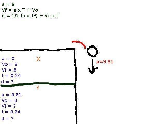

May30-10, 11:14 PM   #71
damn forget that one too.
May30-10, 11:18 PM   #72
Now.
May30-10, 11:18 PM   #73
Now 2
