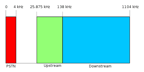

In the following diagram,
of an ADSL signal on a telephone line, the red portion is used for normal speech, while the green and blue areas are used for data.
If you did manage to send data down such a line, the "red" voice section would be wiped out and the line would only be used for data.
Also, you can see that giving the upstream and downstream signals different bands gives them a chance to happen simultaneously without interfering with each other.
But completely wiping out voice band is true for dial-up connection too so that I wouldn't see it as the disadvantage of digital communication against the dial-up.
However, I see your point. Simple digital communication of baseband data causes interfarence between the upstream and downstream and full duplex isn't possible.
